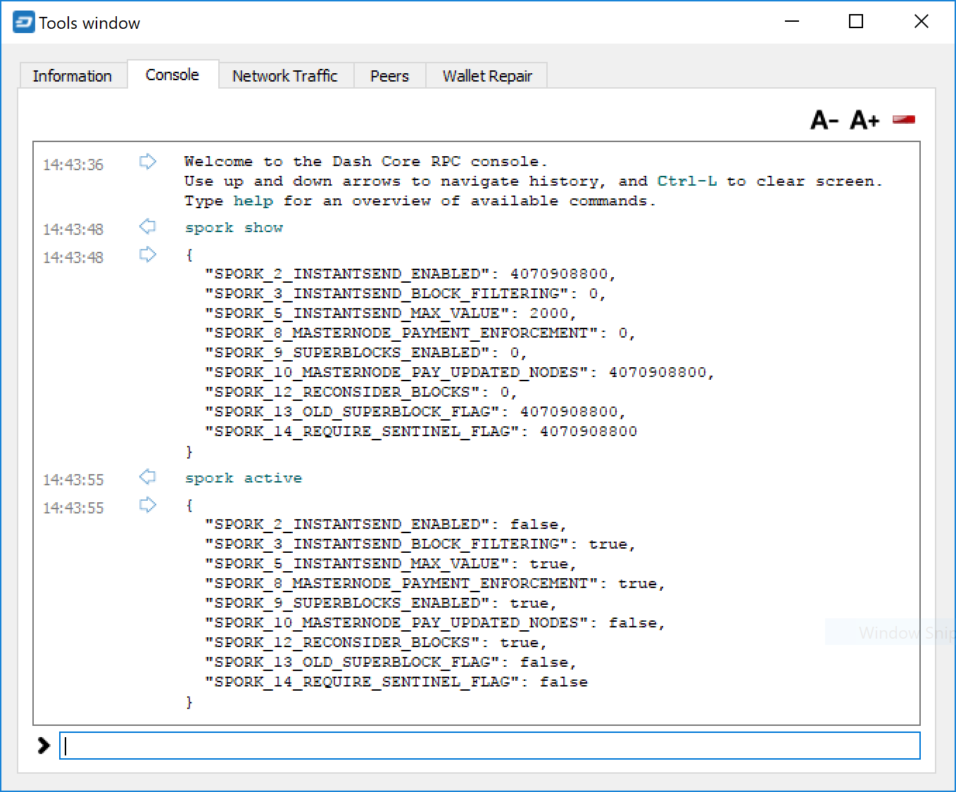

Viewing spork status¶
The spork show and spork active commands issued in the debug
window (or from dash-cli on a masternode) allow you to interact with
sporks. You can open the debug window by selecting Tools > Debug
console.
