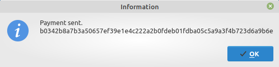

Transaction sent screen showing transaction hash#
