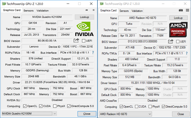

This guide consolidates several other guides on how to use your GPU (the processor on your graphics card) to mine Dash using the X11 algorithm on Windows. Please note that the growing market for ASIC miners means that this if probably not going to be profitable! A lot of the software and binaries described here also have not been updated for several years, so this guide should be used for experimental purposes only.
This guide will cover the process of downloading and configuring the mining software, followed by some suggestions for optimizations. This technology can change rapidly, so we advise you to keep an eye out on mining sites such as these in order to keep up with the latest information and releases.
Mining software¶
As for CPU mining, a range of mining software is available for GPU mining. Most of it based on sgminer compiled with different optimizations specific to different hardware. A good approach is to identify your graphics hardware, then choose an appropriate build of sgminer. You can use GPU-Z to identify your GPU hardware:
Next, download the mining software. Most of these are based on the original sgminer, but this is not suitable for the X11 algorithm, offers no compiled binaries and hasn’t been updated in years. We will describe using pre-compiled binary software maintained by newer developers only.
AMD
NVIDIA
- https://github.com/tpruvot/ccminer/releases (focus on core application)
- https://github.com/sp-hash/ccminer/releases (sp-mod, optimized CUDA kernels for Windows)
- https://github.com/KlausT/ccminer/releases (similar to SP version, more clean)
Download your chosen release and extract the zip file to a known location. The folder should look something like this:
The sgminer file is the executable file, while the various files with .cl extensions define the various algorithms supported by sgminer. In this case, we are interested in the darkcoin.cl and darkcoin-mod.cl implementations of X11. Note that the name of the executable file may be different for miners with different optimizations, for example ccminer for NVIDIA cards.

This is the main option to play around with to improve performance. Intensity correlates with the size of work being submitted at any one time to a GPU. The higher the number the larger the size of work. Generally speaking, finding an optimal value rather than the highest value is the correct approach as hash rate rises up to a point with higher intensities but above that, the device may be very slow to return responses, or produce errors
xintensity is a new setting that replaces the older intensity
setting. It should be inserted together with the worksize setting after
the pools : [ ] section as follows:
"pools" : [
"user" : "walletaddress",
"pass" : "x",
"algorithm":"darkcoin"
"xintensity" : "64",
"worksize": "64"
From the documentation:
This new setting allows for a much finer grained intensity setting and also opens up for dual GPU threads on devices not previously able to. Note: make sure to use lower thread-concurrency values when you increase CPU threads. It is simply a shader multiplier, obviously based on the amount of shaders you got on a card, this should allow the same value to scale with different card models.
- 6970 with 1536 shaders: xI:64 = 98304 threads
- R9 280X with 2048 shaders: xI:64 = 131072 threads
- R9 290 with 2560 shaders: xI:64 = 180224 threads
- R9 290X with 2816 shaders: xI:64 = 163840 threads
- 6970 with 1536 shaders: xI:300 = 460800 threads
- R9 280X with 2048 shaders: xI:300 = 614400 threads
- R9 290 with 2560 shaders: xI:300 = 768000 threads
- R9 290X with 2816 shaders: xI:300 = 844800 threads
Try xintensity = 64 first and play around with the number to see
which gives you the best performance with the lowest error rate. The
errors. Or you can Google around for your card with the recommended
xintensity setting. Do not change the worksize setting, particularly if
using Wolf0’s binaries. Save sgminer.conf in the same folder as your
sgminer.exe.
