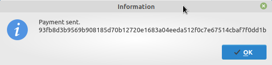

Confirm ProUpRegTx Transaction¶
Transaction sent screen showing transaction hash¶

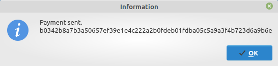

Confirm ProUpServTx Transaction¶
