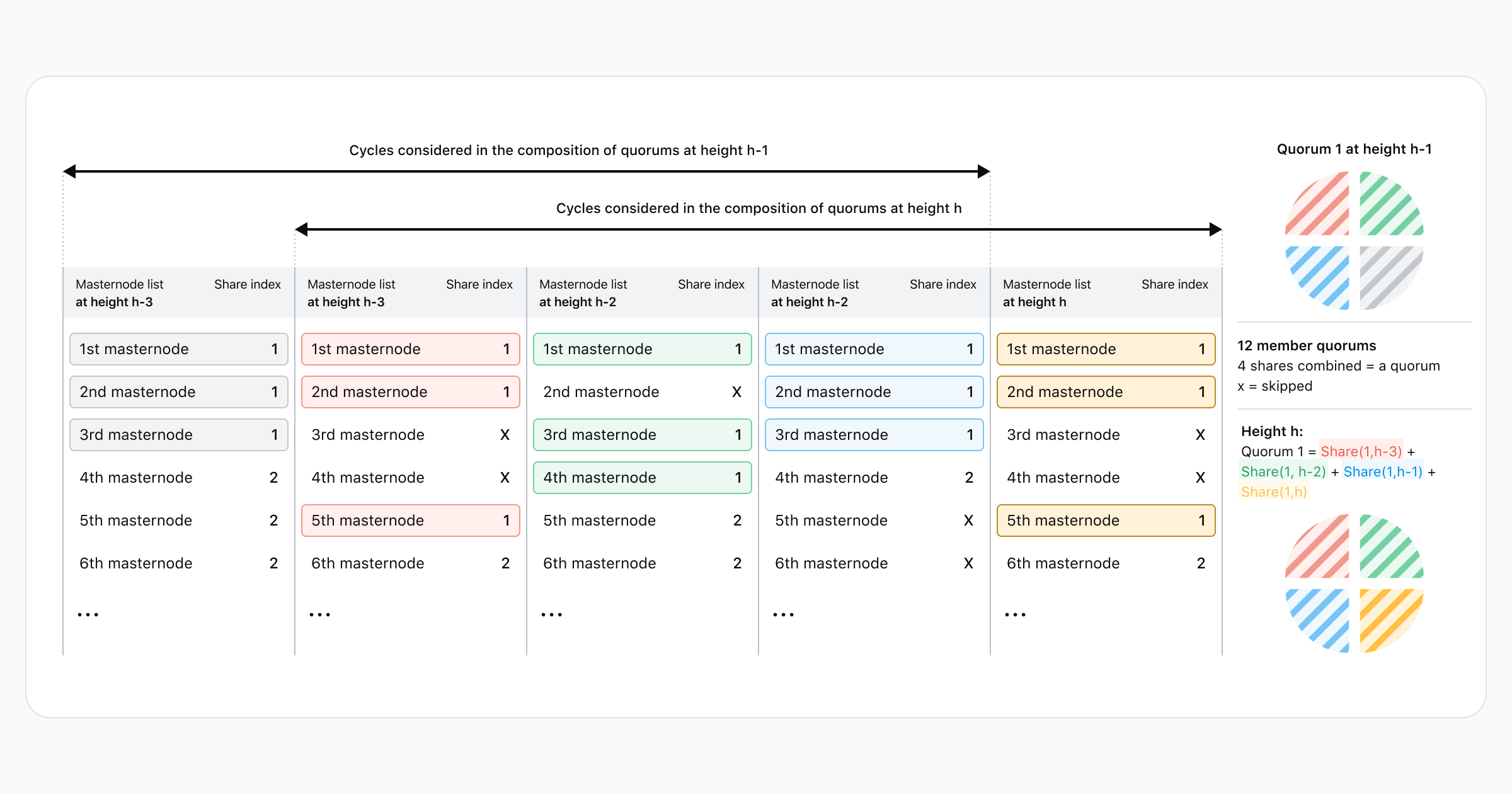

This new system works cyclically. Each cycle, the oldest quarter (produced at height h-4c) is replaced by the newly created quarter while the remaining ¾ of participants remain unchanged (c is the number of blocks in a cycle - equivalent to the DKG interval). This process results in quorums being totally renewed every 4 cycles.
The diagram below demonstrates the creation of a mock quorum out of four such shares. At each height, the masternode list is ordered pseudo-randomly, a new share is built from this list, and then the quorum is composed with the 4 newest shares.
Important notes regarding the diagram:
  • The ordering of the list differs at each height. For example, the first masternode at height h-3 is not the same node as the first masternode at height h-2.
  • The mock quorums』 cycles only last 1 block.
  • The selection algorithm may skip Masternodes. The details of the algorithm are covered in the “Changes to the initialization phase” section below.

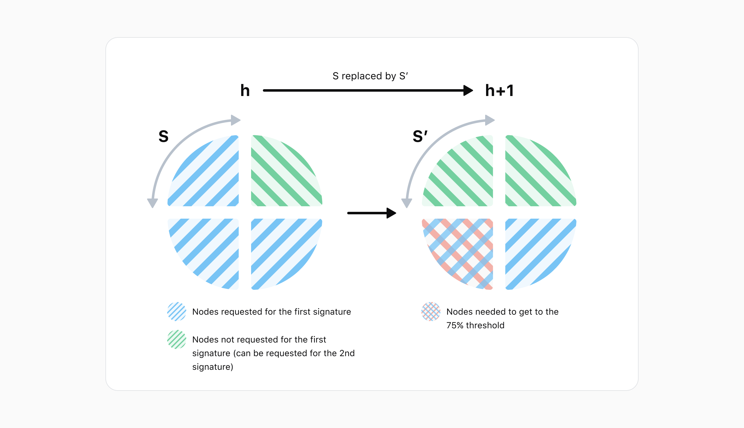

Below is a diagram representing what happens in the second example with 4 shares and a threshold t = 75% = 3/4. We see that we need 25% of the quorum under our control to successfully complete the second signing request and thus the attack.
Four share scenario

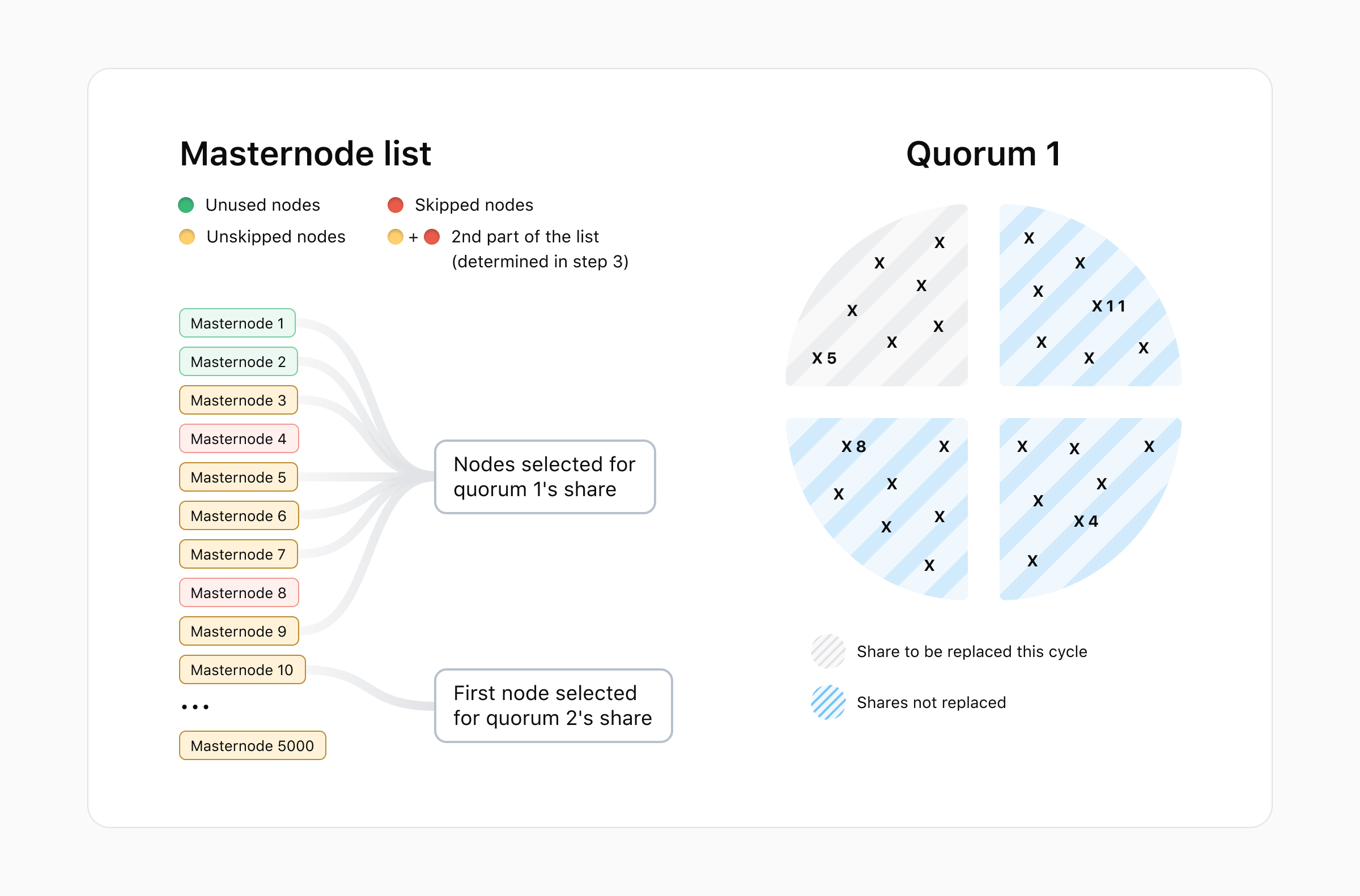

Example member selection#
Below is a representation of the node selection and skipping for a mock quorum of size 28 (7*4) nodes. Crosses represent masternodes and numbers represent the related position of the node in the current masternode list for the initialization phase. We see that masternode 5 can be selected again as it is not in the last 3 quarters. On the other hand, masternodes 4 and 8 are skipped because they are still present in the quorum at the start of the cycle. Masternode 11 is not considered for quorum 1 and, as such, is not problematic.

  6. Repeat step 5 for each quorum index.
To recreate the quorums at height h, the quarters at height h, h-c, h-2c, and h-3c are needed. Thus, light clients will need the information described above for the heights h-c, h-2c, and h-3c. Using this information, they will be able to recreate the quarters from those 3 heights. Then, the last quarters (at height h) can be deduced without additional information by enacting the algorithm described in the initialization section.
