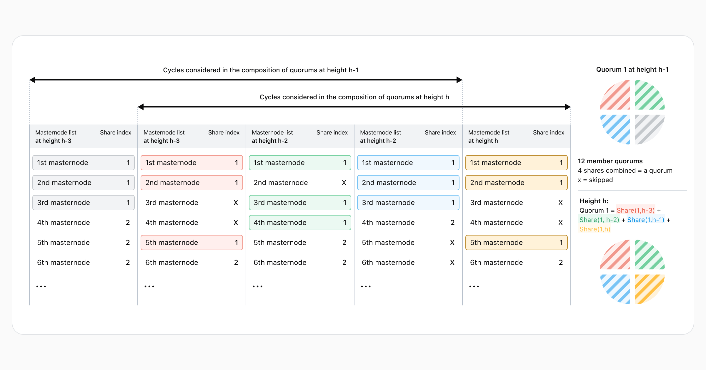

Masternode selection#
Another major change is in the way masternodes are selected to be part of a quorum. In the old system, this was done based solely on the most recent masternode list. The new system will compose each quorum by aggregating 4 quorum shares with each share being a quarter of the quorum.
This new system works cyclically. Each cycle, the oldest quarter (produced at height h-4c) is
replaced by the newly created quarter while the remaining ¾ of participants remain unchanged (c is
the number of blocks in a cycle - equivalent to the DKG interval). This process results in quorums
being totally renewed every 4 cycles.
The diagram below demonstrates the creation of a mock quorum out of four such shares. At each height, the masternode list is ordered pseudo-randomly, a new share is built from this list, and then the quorum is composed with the 4 newest shares.
Important notes regarding the diagram:
The ordering of the list differs at each height. For example, the first masternode at height
h-3is not the same node as the first masternode at heighth-2.The mock quorums' cycles only last 1 block.
The selection algorithm may skip Masternodes. The details of the algorithm are covered in the “Changes to the initialization phase” section below.

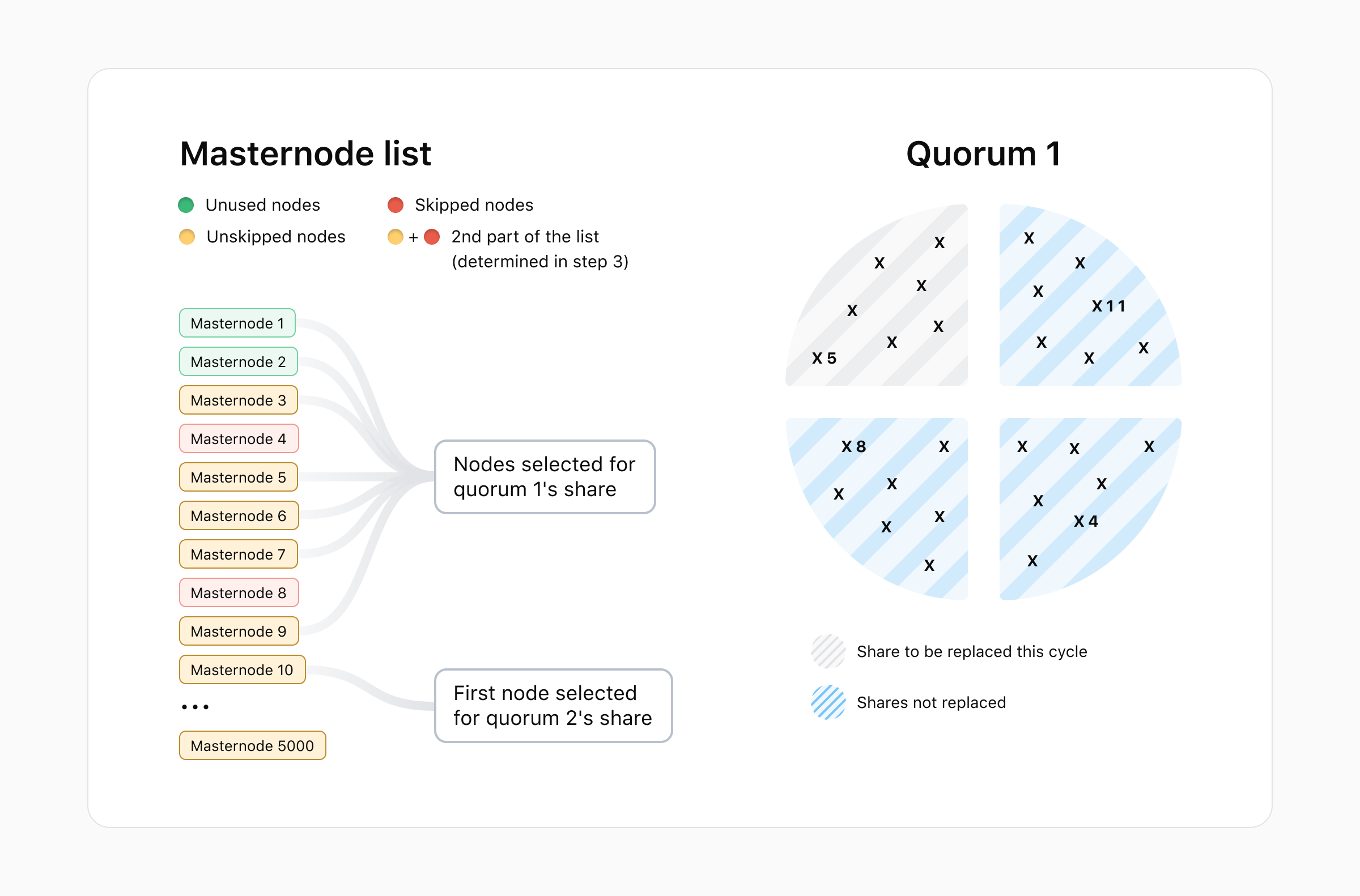

Example member selection#
Below is a representation of the node selection and skipping for a mock quorum of size 28 (7*4) nodes. Crosses represent masternodes and numbers represent the related position of the node in the current masternode list for the initialization phase. We see that masternode 5 can be selected again as it is not in the last 3 quarters. On the other hand, masternodes 4 and 8 are skipped because they are still present in the quorum at the start of the cycle. Masternode 11 is not considered for quorum 1 and, as such, is not problematic.
After the member list is built, the LLMQ members start establishing connections to the deterministic set of quorum members and initializing the necessary DKG sessions, one per block, as described in the Intra-Quorum Communication section of DIP-6. Then all quorums delay mining the phase to sync it with the last DKG session's mining phase.
