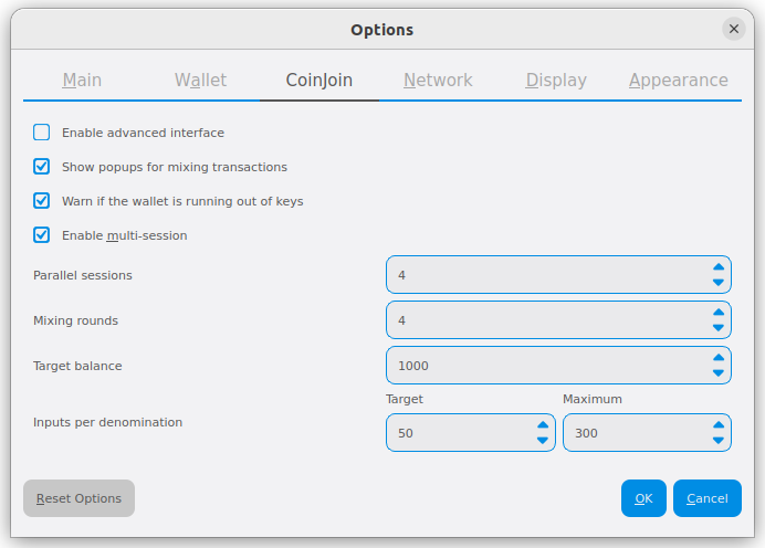

Configuration#
  1. Open your Dash Core wallet, go to Settings and select Options. Go to the CoinJoin tab.
  2. Next to Mixing rounds, enter a value between 2-16. Each round of CoinJoin performs one CoinJoin transaction, known as a denomination. Higher numbers of rounds increase your overall level of privacy while decreasing the chance of detection via node collusion. 16 is the highest number of rounds currently available.
  3. Enter a Target balance. This value provides a lower boundary on the final amount of funds to be processed. Depending on how the client splits your wallet balance, you may end up with denominated inputs whose sum total is slightly greater than the target amount.
  4. Click OK to save settings.
  5. CoinJoin is disabled by default when you open the wallet. It will only start after you set the number of rounds and number of Dash to process under settings and click Start CoinJoin on the Overview tab of your wallet.
Several advanced options are also available on this screen for users that require more control:
  • Inputs per denomination values allow limiting how many inputs are created. This can be helpful if you end up with too many small denominations.
  • Parallel sessions sets how many separate masternodes should be used in parallel if multi-session mixing is enabled.
