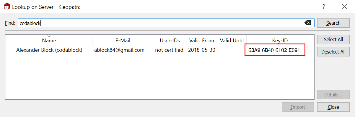

Download the key files above. Install Gpg4win if it is not already available on your computer. Once it is installed, open the Kleopatra certificate manager and click File -> Import. Import the key files and verify the Key-ID matches the ID above.
Importing codablock’s GPG public key#
Skip any requests to certify the certificate with your own key. Next,

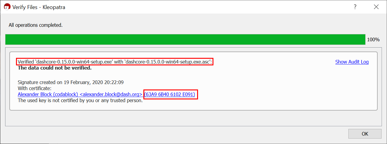

click Decrypt/Verify… and select the detached signature file named
dashcore-19.2.0-win64-setup.exe.asc in the same folder as the
downloaded installer.
If you see the first line of the message reads Verified
dashcore-19.2.0-win64-setup.exe with
dashcore-19.2.0-win64-setup.exe.asc then you have an authentic copy
of Dash Core for Windows.
The binary installer has been verified#
