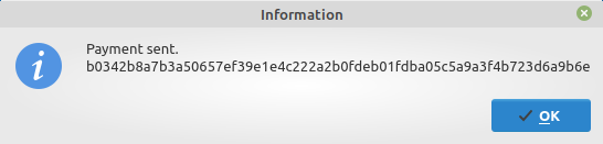

Confirm ProRegTx Transaction#
Transaction sent screen showing transaction hash#

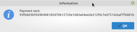

Confirm ProUpRegTx Transaction#
