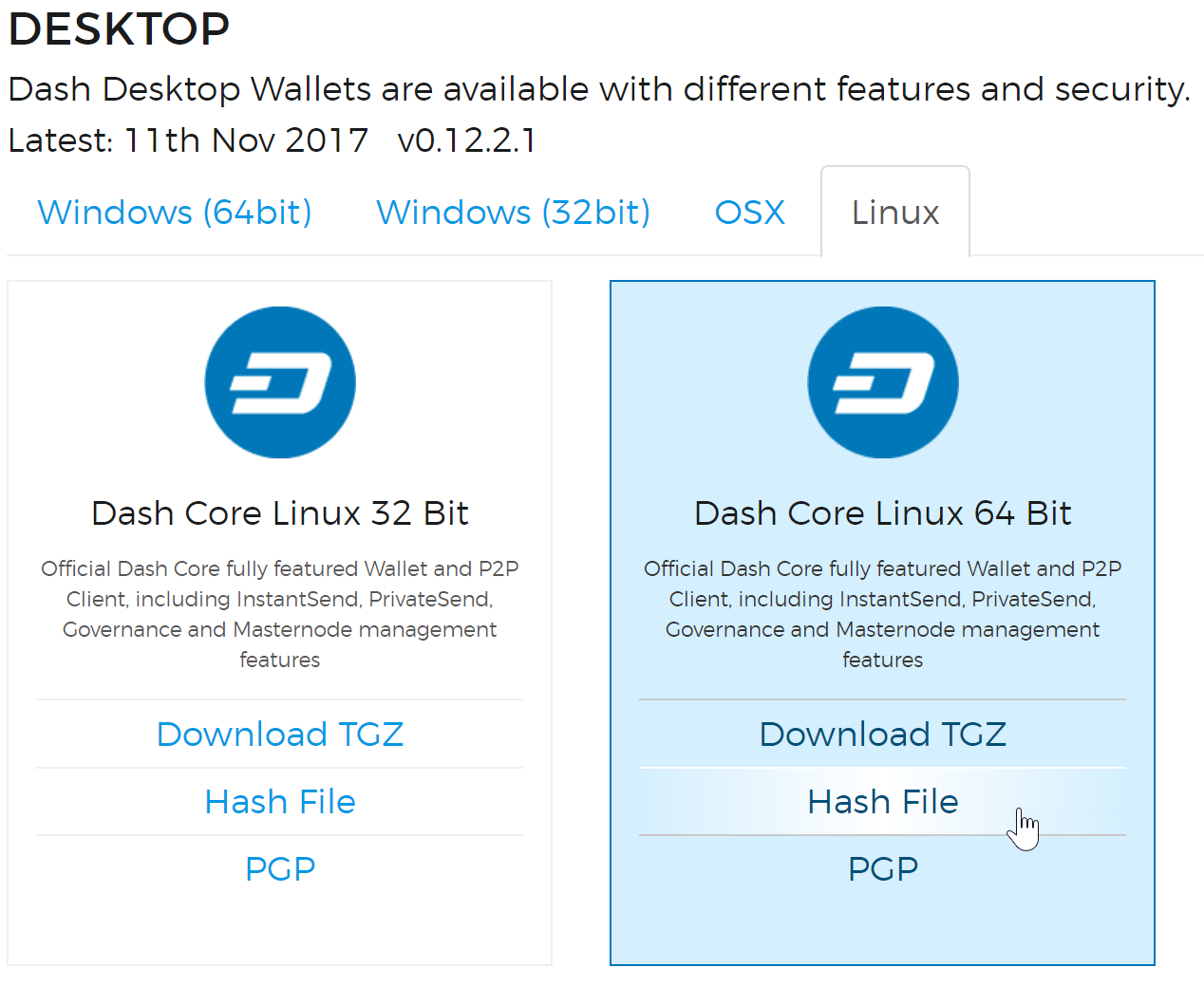

Verify the integrity of your download by running the following command and comparing the output against the value for the file as shown on the Dash website under Hash File:
sha256sum dashcore-0.12.2.3-linux64.tar.gz
../_images/setup-manual-download.png
Link to the hash file to verify download integrity
