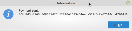

Registering your masternode#
Since the ProRegTx information required to register the masternode was filled out by the previous step, just Click Pay... to complete the registration.
Ghi chú
Send tab with ProRegTx prepared#
Confirm ProRegTx Transaction#
Transaction sent screen showing transaction hash#
