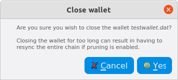

To close a wallet, set it as the active wallet using the wallet selection dropdown box. Next, click File -> Close Wallet and then click Yes on the Close wallet confirmation screen.
Close wallet confirmation#
