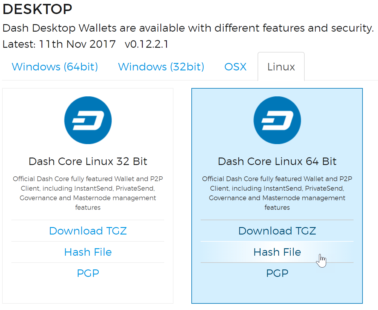

P2Pool requires a full Dash node to be running to get block and transaction data. To download and install Dash, visit https://www.dash.org/downloads on your computer to find the link to the latest Dash Core wallet. Click Linux, then right-click on Download TGZ for Dash Core x64 and select Copy link address. Go back to your terminal window and enter the following command, pasting in the address to the latest version of Dash Core by right clicking or pressing Ctrl + V:
cd ~
wget https://github.com/dashpay/dash/releases/download/v0.16.0.1/dashcore-0.16.0.1-x86_64-linux-gnu.tar.gz
Verify the integrity of your download by running the following command and comparing the output against the value for the file as shown on the Dash website under Hash File:
sha256sum dashcore-0.16.0.1-x86_64-linux-gnu.tar.gz
