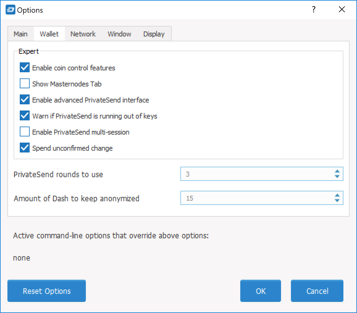

Open your Dash Core wallet, go to Settings and select Options. Go to the Wallet tab.
Next to PrivateSend rounds to use, enter a value between 1-16. Each round of PrivateSend performs one denominated fund mixing transaction. Higher numbers of rounds increase your overall level of privacy while decreasing the chance of detection via node collusion. 16 is the highest number of rounds currently available.
NOTE: To prevent system abuse, an average of one in ten rounds of masternode mixing incurs a fee of .0001 DASH.
Enter a target value for Amount of Dash to keep mixed. This value provides a lower boundary on the final amount of funds to be mixed. Depending on how the client splits your wallet balance, you may end up with denominated inputs whose sum total is greater than the target amount. In this case the client will use all existing denominated inputs in the PrivateSend process. The final mixed amount may be higher than your target, but should be close.
Click OK to save settings.

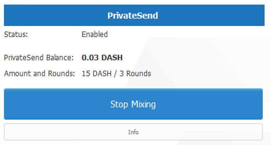

PrivateSend is disabled by default when you open the wallet. It will only start after you set the number of rounds and number of Dash to mix under settings and click Start Mixing on the Overview tab of your wallet.
Starting Mixing¶
The PrivateSend process is initiated by clicking the Start Mixing button on the Overview tab of the Dash Core wallet. Mixing is possible once the following conditions have been met:

PrivateSend will begin creating transactions and your PrivateSend balance will gradually increase. This process can take some time, so be patient. You can monitor the process in more detail as described in the following section.

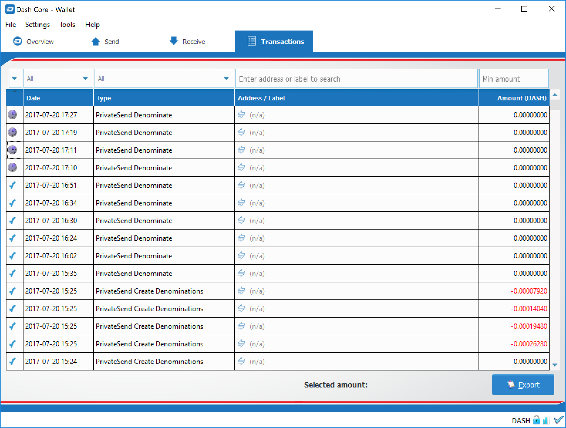

You can also monitor PrivateSend progress by viewing the transactions created by the mixing process on the Transactions tab.
The following table describes the PrivateSend-related transactions displayed in the Type column of the Transactions tab:
| PrivateSend Transaction Type | Transaction Description |
| PrivateSend Make Collateral Inputs (Mixing) | Wallet funds were moved to collateral inputs that will be used to make collateral payments. This is done to minimize traceability of collaterals. |
| PrivateSend Create Denominations (Mixing) | Wallet funds were broken into PrivateSend denominations (Step 1 here) |
| PrivateSend Denominate (Mixing) | A transaction was sent to a masternode in order to participate in a mixing session (Step 3 here) |
| PrivateSend Collateral Payment (Mixing) | The mixing session collateral was claimed. This fee is charged in ~10% of mixing sessions to prevent spam attacks. |
| PrivateSend (Spending) | Mixed funds were used to send a payment to someone. Note: Unlike the previous 4 transaction types, this is not a mixing process transaction. |

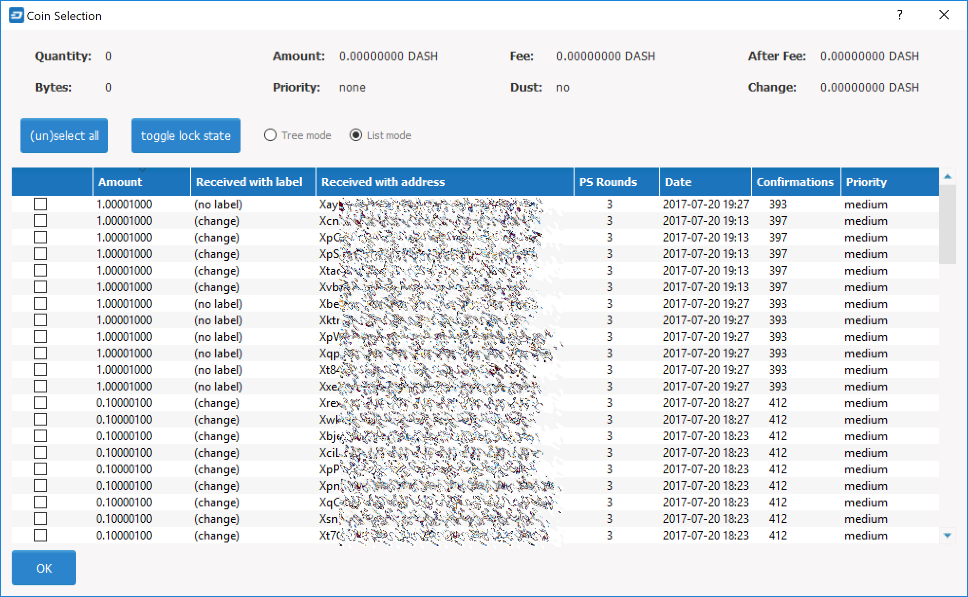

You can also use the coin control feature to view which addresses hold mixed denominations ready to be used for PrivateSend transactions. Go to the Send tab of your wallet and click Inputs to view the possible input addresses for your transactions. You can see how each address holds given denominations of mixed Dash, and how many rounds of mixing have been completed. This is to ensure that an efficient combination of addresses can be used as inputs in PrivateSend transactions without too much change, since amount in a PrivateSend transaction must be rounded up to completely spend all inputs. The current minimum balance for an input used in a PrivateSend transaction is 0.00100010 DASH.

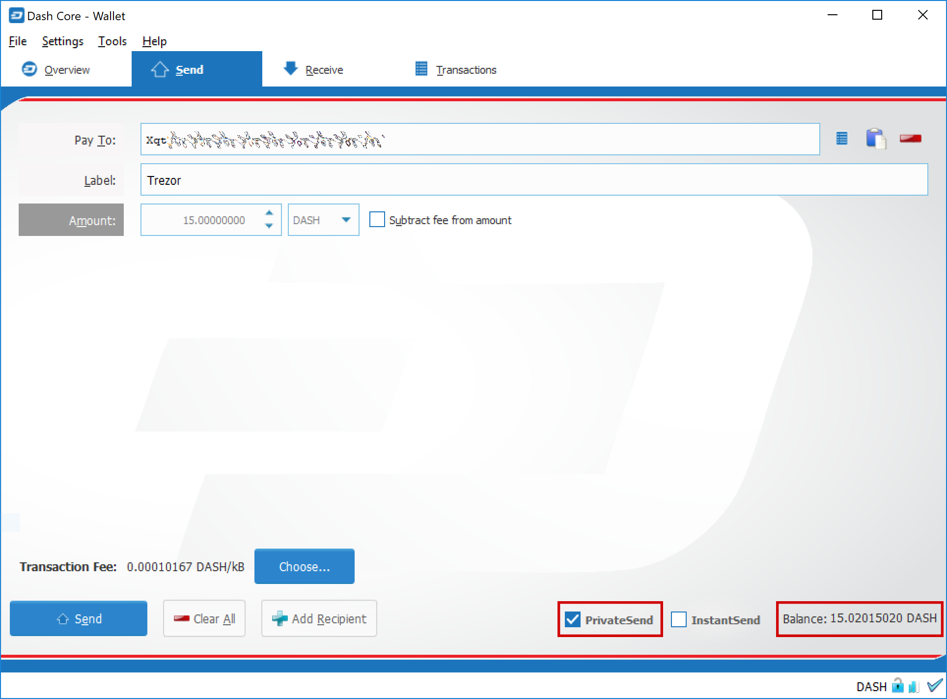

To send a payment using PrivateSend, go to the Send tab of the Dash Core wallet and enable the PrivateSend option. The balance displayed will change to show your PrivateSend balance instead of the total balance. You can then enter the Pay To address, Label, Amount and click Send as usual. Your payment will be rounded up to completely spend the lowest possible denomination of mixed balance available (currently to the nearest 0.001 DASH). You will be prompted to enter your password and receive a detailed breakdown of the fee structure for PrivateSend before sending.
