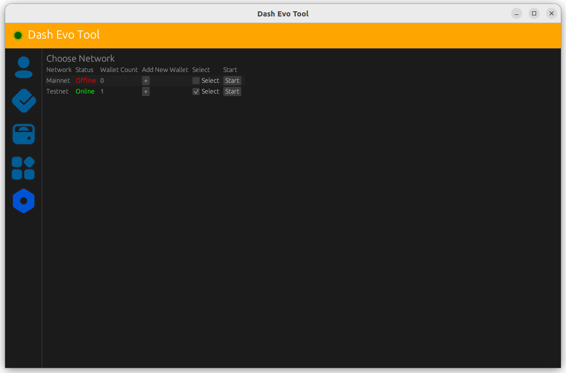

Network selection#
ملاحظة
You can also launch Dash Core manually without using the Dash Evo Tool. This may be necessary if Dash Core is installed in a non-standard location. When launching Dash Core manually, you must enable ZMQ as described in Configuration Step 3.

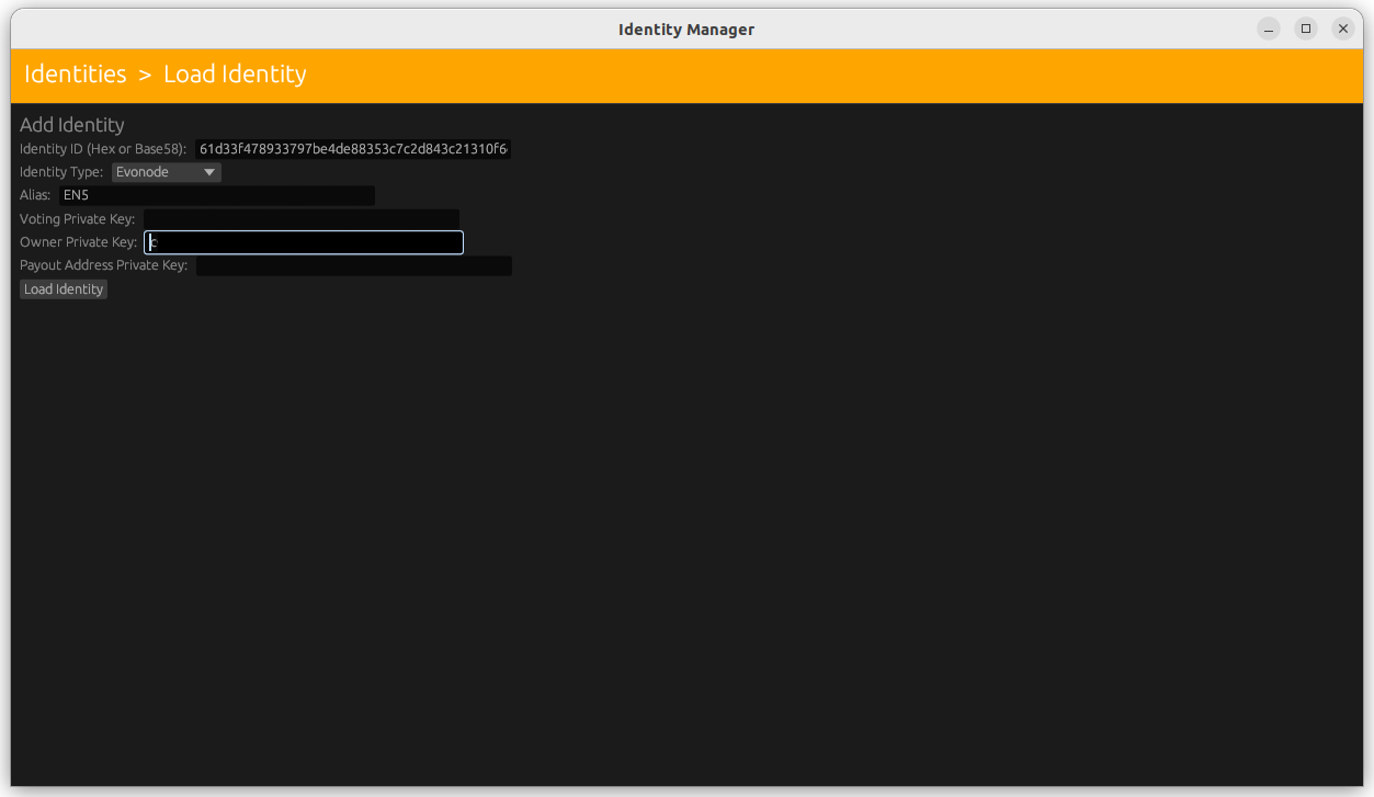

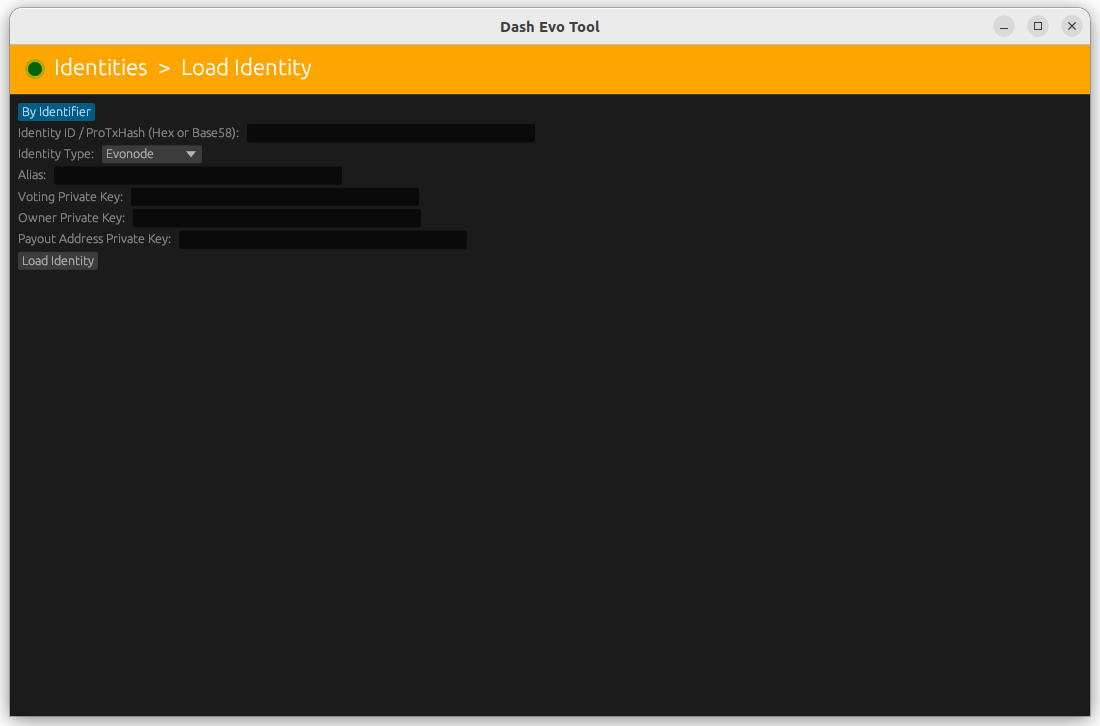

Load existing identity#
Identity screen with no loaded identities#

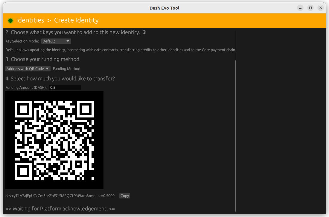

Create new identity#
نصيحة

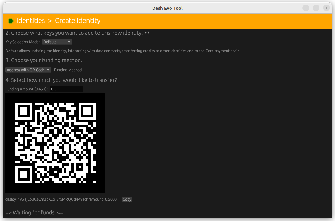

On the create identity screen, leave the first two options set to the default and select the funding method. Then, send the requested amount of DASH to the provided address.
Waiting for funds#
The status will change from "Waiting for funds" to "Waiting for Platform acknowledgement" once the funds have been received and the identity registration process has started.

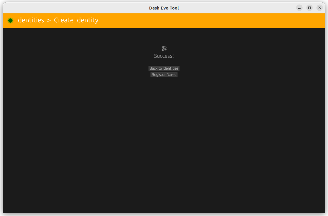

Identity creation success#

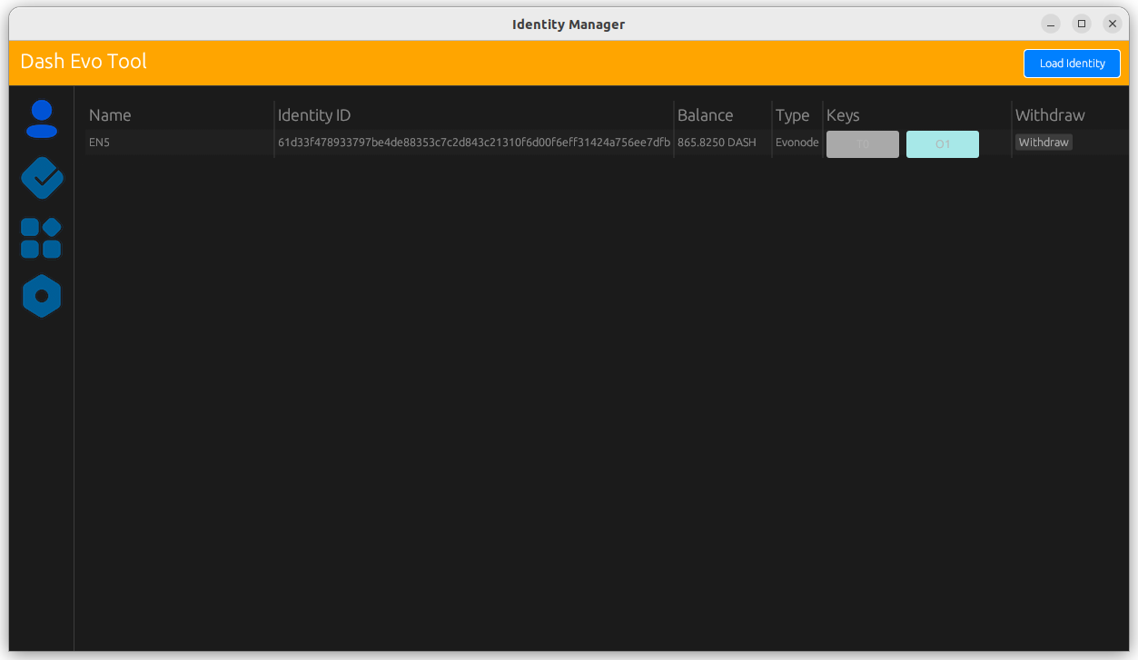

Identity screen with an identity loaded#

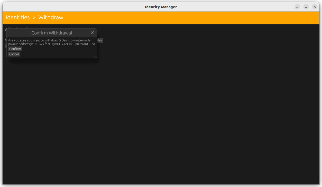

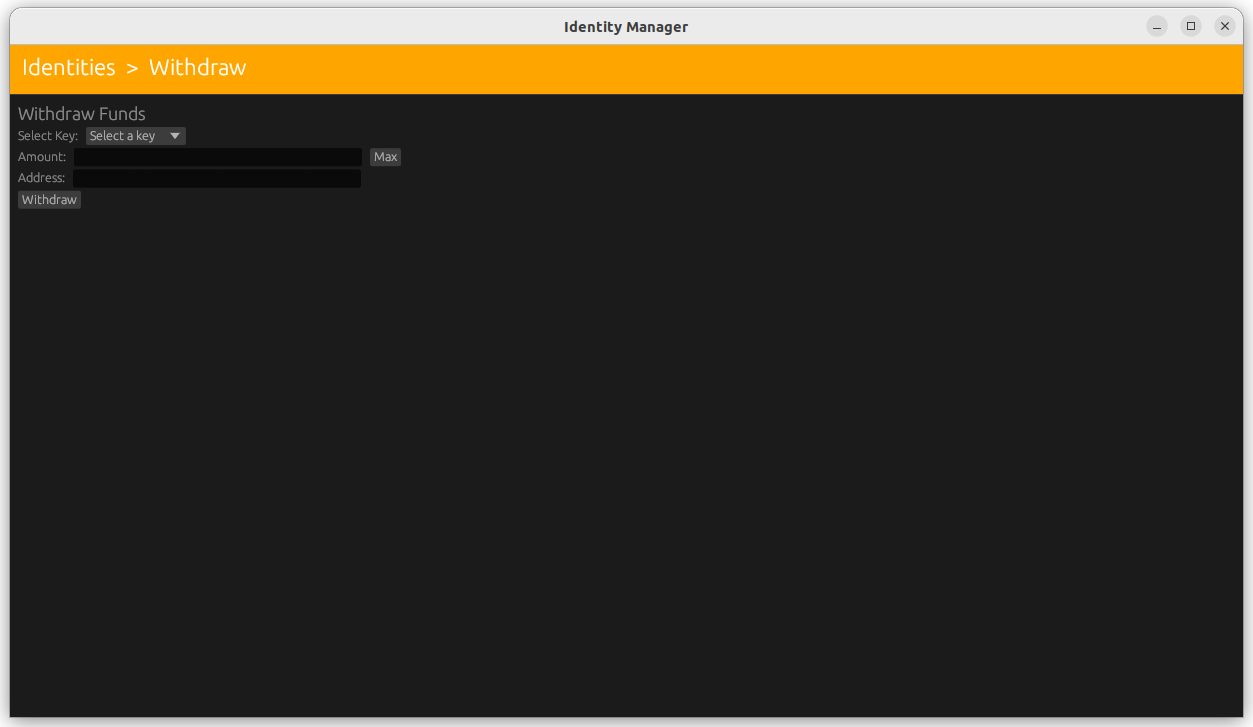

Evonode withdrawals#
ملاحظة
Withdrawal requests enter a queue that is currently processed more slowly than intended. Depending on the timing of the withdrawal request, it may take up to 18 hours to complete.
For security, there is also a limit on how much can be withdrawn from Platform daily. If withdrawal requests hit the daily limit, they will remain in the queue longer. For details, see this DCG development update.

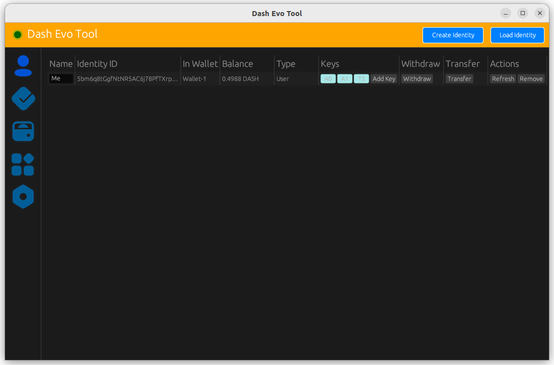

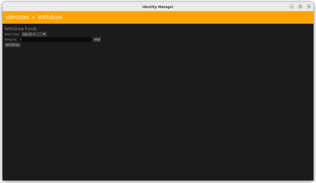

From the identity main screen, click the Withdraw button for an identity.
ملاحظة
The Max button currently has a bug and sets the withdrawal amount in credits instead of DASH, so you will need to manually adjust the amount if you use that button.

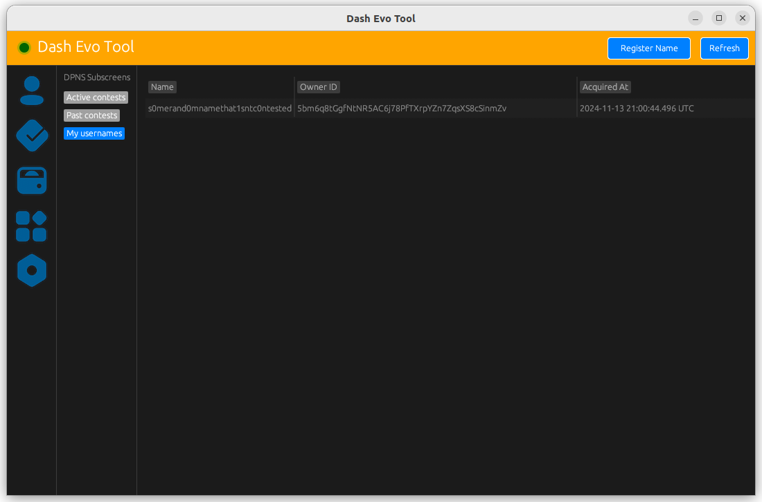

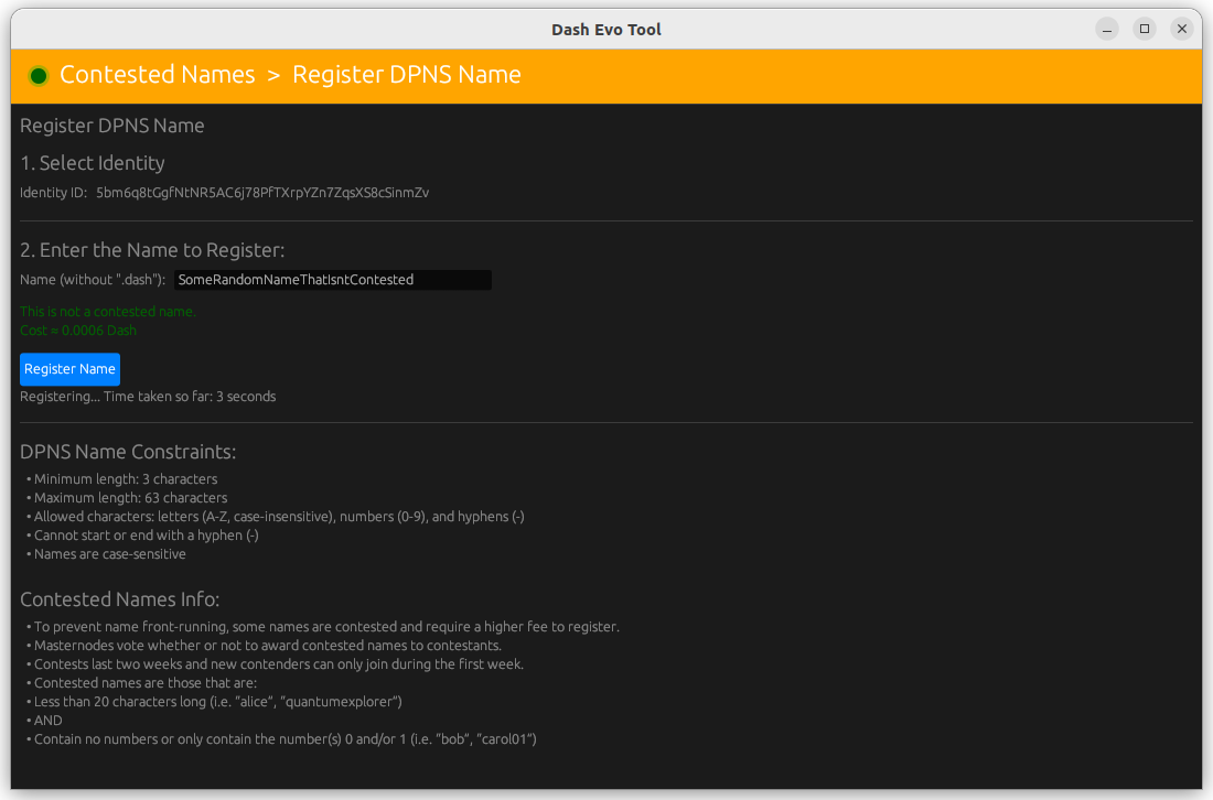

Register name#
Name screen#
Name registration#
Name registered successfully#

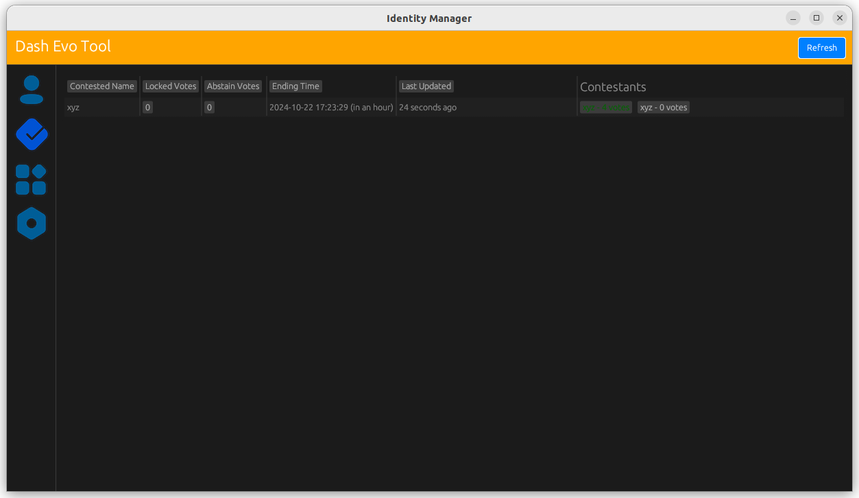

Vote for names#
ملاحظة
Voting screen#

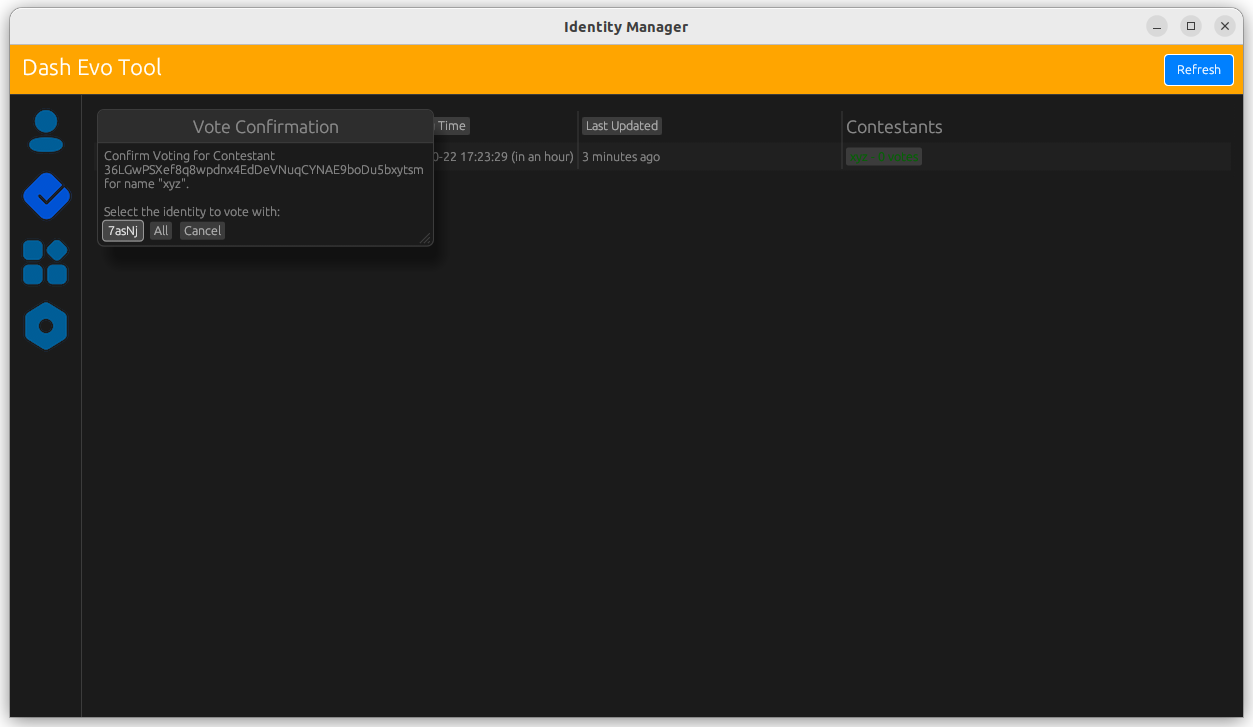

To vote for a contestant, click on an entry in the Contestants column. You can also vote to Lock the name or Abstain by clicking the value in those columns. You will be prompted to load an evonode or masternode identity if you have not already done so.
After clicking one of the contestants, vote for that identity to receive the name by clicking one of your specific identities on the Vote Confirmation screen. Click All to vote with all your loaded identities simultaneously.
Vote confirmation screen#

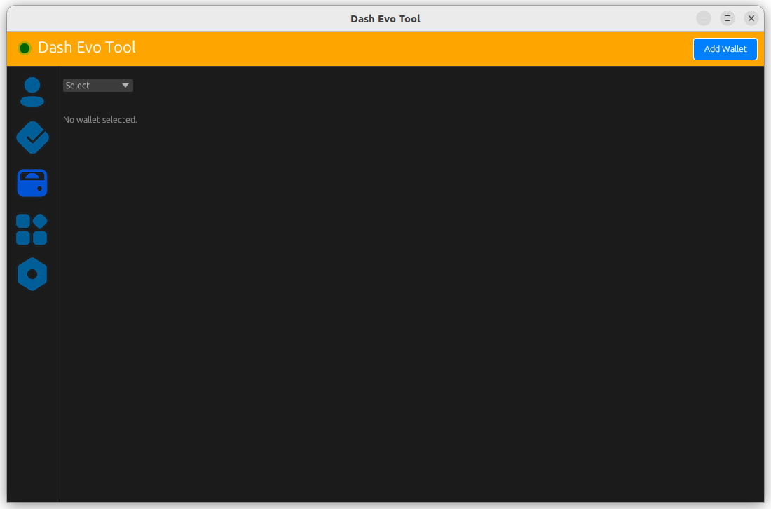

Wallet operations#
ملاحظة
Create wallet#
تنبيه
Since this tool adds watching-only addresses to Dash Core when creating identities, it is recommended to close all existing Dash Core wallets and create a new, empty wallet for the Dash Evo Tool. Also, make sure to backup your Dash Core wallet.

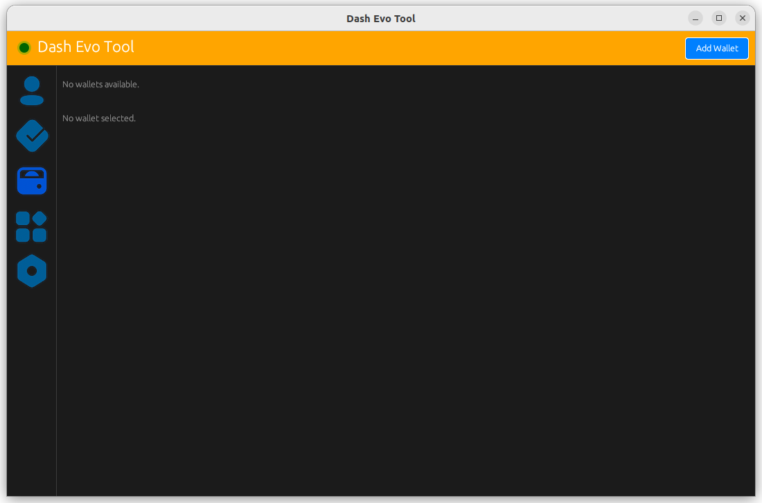

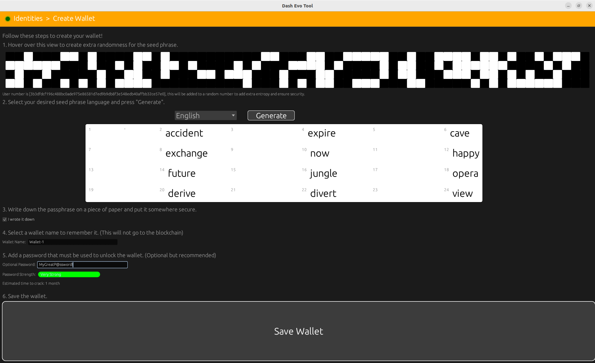

Click Add Wallet to create a new wallet.
Wallet screen#
After creating extra randomness with the mouse, select your preferred language and click Generate to display you passphrase. Write it down and store it securely, then click the checkbox in step 3 to confirm.
Next, enter a wallet name and optionally add a password before clicking Save Wallet to store the wallet.
Wallet create screen#

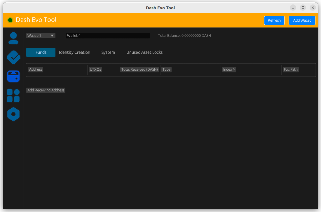

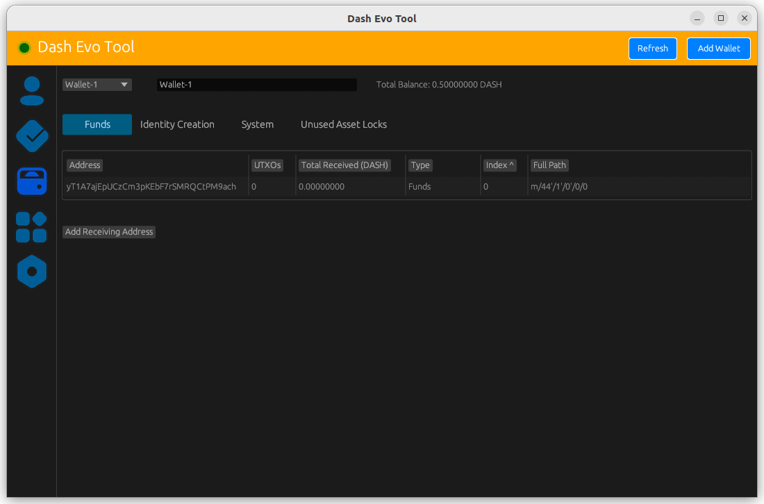

Funds#
Wallet Funds tab#
Wallet with address added#
