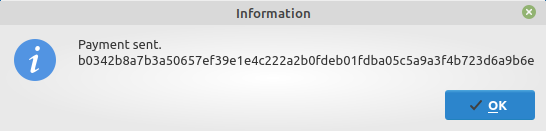

Confirm ProRegTx Transaction#
Transaction sent screen showing transaction hash#

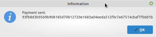

Confirm ProUpServTx Transaction#
