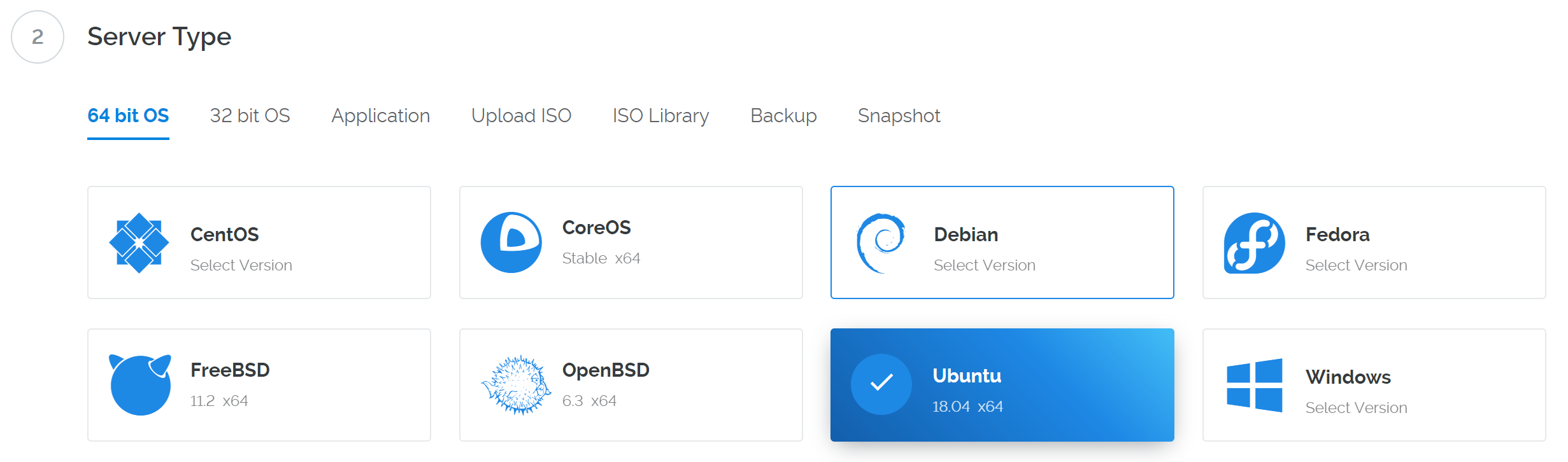

Select Ubuntu 18.04 x64 as the server type. We use this LTS release of Ubuntu instead of the latest version because LTS releases are supported with security updates for 5 years, instead of the usual 9 months.

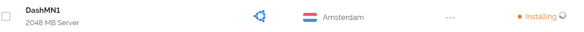

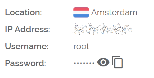

Vultr现在将安装您的服务器。这个过程可能需要几分钟。
在安装完成后,单击 Manage ,并记下IP地址、用户名和密码。

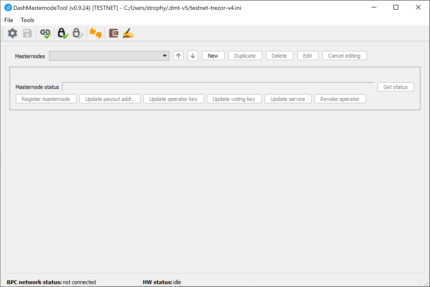

在我们等待15次确认时,从GitHub发布页面下载达世币主节点工具(DMT)的最新版本。解压并运行该文件。以下窗口将出现。

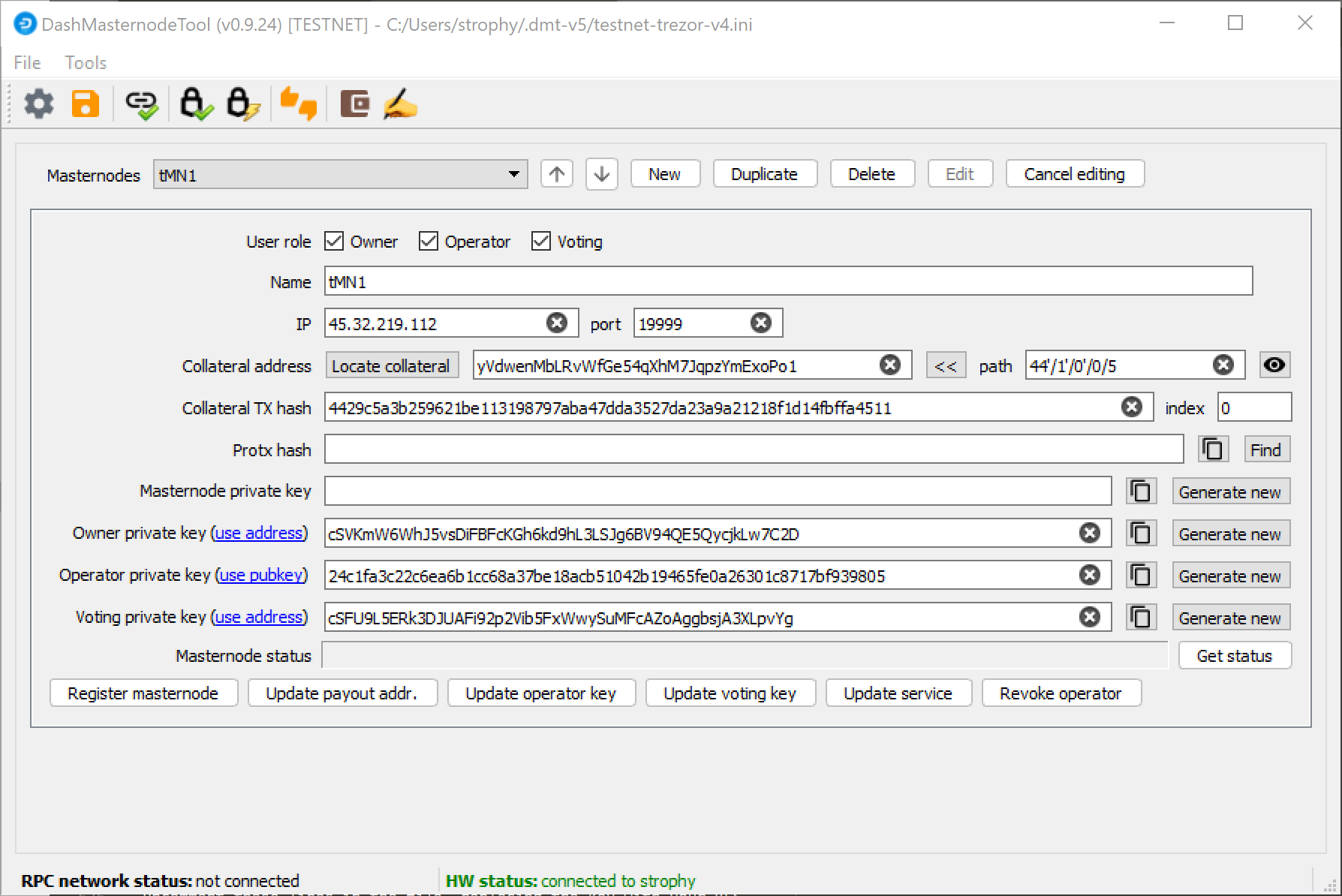

- Click the New button.
- Enter a name for your masternode. The host name you specified for your VPS above is a good choice.
- Enter the IP address of your masternode. This was given to you by the VPS provider when you set up the server. Then enter the TCP port number. This should be 9999.
- Click Locate collateral to view unused collateral funding transactions available on the connected hardware wallet. Select the address to which you sent 1000 Dash and click Apply. The Collateral address, path, Collateral TX hash and index fields should be filled automatically.

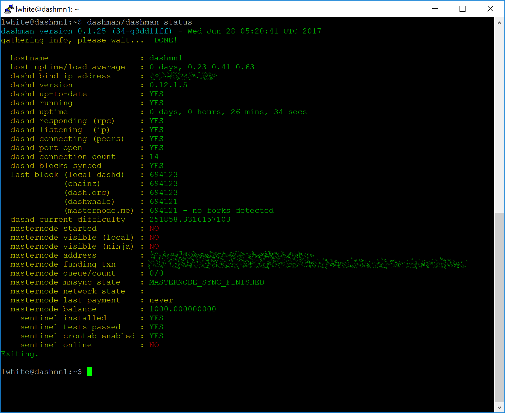

~/dashman/dashman status
Continue with the next step to register your masternode.

Go back to DMT and ensure that all fields from the previous step are still filled out correctly. Click Generate new for the three private keys required for a DIP003 deterministic masternode:

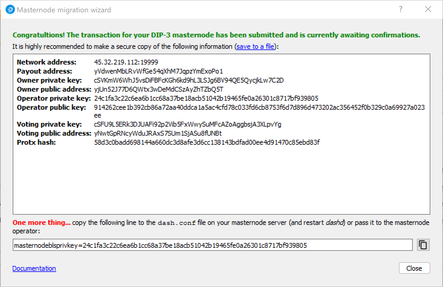

- Owner private key
- Operator private key
- Voting private key
The BLS private key must be entered in the dash.conf

masternode using ~/dashman/dashman status
, by entering
~/.dashcore/dash-cli masternode status
or using the Get status
此时,您可以通过键入exit
来安全地注销您的服务器。祝贺您!您的主节点现在正在运行。
