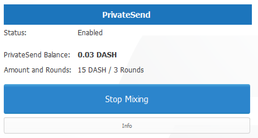

匿名发送功能将开始创建交易,用户的匿名发送金额将会逐渐增加。这个过程可能需要花费一些时间,所以用户需要一些耐心。在此期间,用户可以对整个流程进行监控,具体细节如下所述。
以下行为都有可能会造成混币流程的中断。由于交易是由众多币混合形成的(因此它要么处于完成的状态,要么就处于没有完成的状态)。正因为这样,用户可以安全地中断匿名发送功能的混币流程。
- 点击概览中的停止混币按键
- 在匿名发送功能的混币流程完成之前关闭客户端
- 在混币流程完成之前用钱包进行匿名发送
- 在混币结束后禁用匿名发送

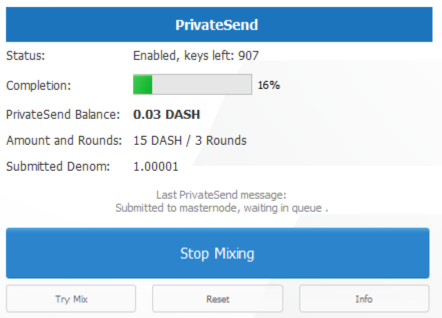

对混币的监控¶
如果想要对匿名发送功能进行更细致的监控,用户就需要启用一些更加高级的钱包功能。用户需要访问设置,选中选项,再打开钱包选项卡。接下来,用户需要选中启用混币管控功能和启用高级的匿名发送界面。
这将帮助用户监控混币流程,跟进匿名发送在后台的进展。
Since PrivateSend mixing creates a lot of new address keys to send and receive the mixed denominations, you may receive a warning when the number of remaining keys runs low. This is nothing to be worried about, since the wallet will simply create more keys as necessary. However, these keys will not exist in any previous backups of your wallet. For this reason, it is important to backup your wallet again after mixing is complete.

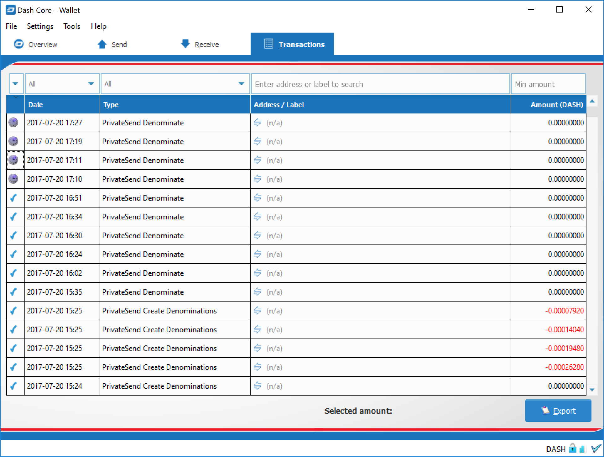

用户也可以通过在交易选项中浏览混币流程创建的交易来监控匿名发送功能。
以下表格显示了与匿名发送功能相关的交易,它将显示在交易选项中的类型列表当中:
| 匿名发送交易类型 | 交易描述 |
| 匿名发送功能创建的保证金输入(混币) | 钱包的资金将被移用作保证金输入,从而完成有担保的支付。这将降低他人追溯资金来源的可能性。 |
| 匿名发送功能创建的交易面值(混币) | 钱包中的资金面额化(步骤1 请参考这里) |
| 匿名发送的面额化(混币) | 交易将被发送到主节点上,以便参与到混币流程当中(步骤3 请参考这里) |
| 匿名发送功能的保证金发送(混币) | 收取混币流程的保证金。为了避免垃圾邮件的攻击,混币流程需要用户支付混币金额的~10%作为保证金。 |
| 匿名发送(发送) | 完成混币后的资金将被发送给其他用户。请注意:与上述的4种交易类型不同的是,这是一个不涉及混币流程的交易。 |

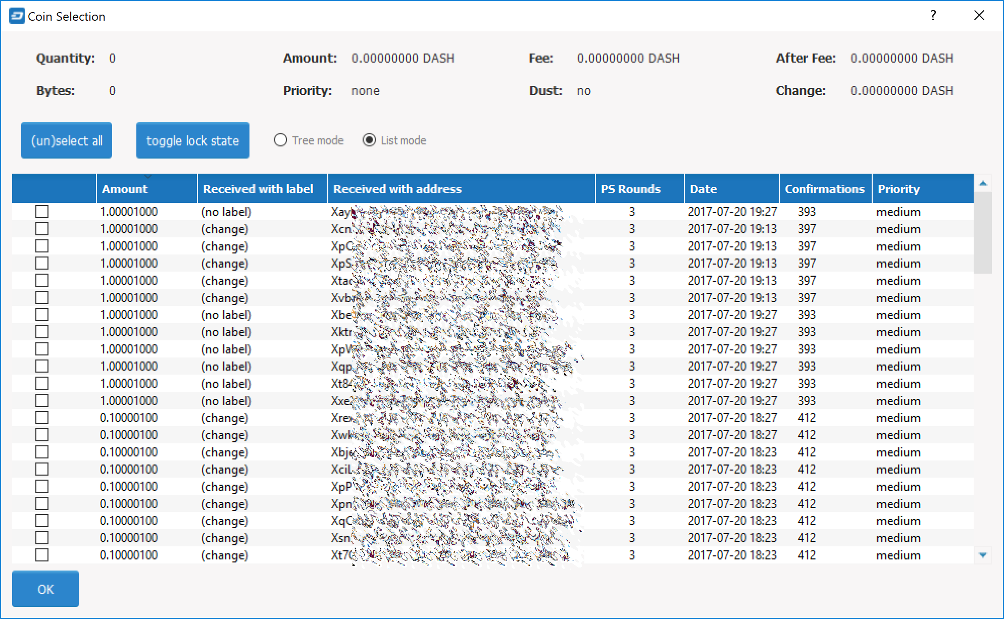

You can also use the coin control feature to view which addresses hold mixed denominations ready to be used for PrivateSend transactions. Go to the Send tab of your wallet and click Inputs to view the possible input addresses for your transactions. You can see how each address holds given denominations of mixed Dash, and how many rounds of mixing have been completed. This is to ensure that an efficient combination of addresses can be used as inputs in PrivateSend transactions without too much change, since amount in a PrivateSend transaction must be rounded up to completely spend all inputs. The current minimum balance for an input used in a PrivateSend transaction is 0.00100010 DASH.

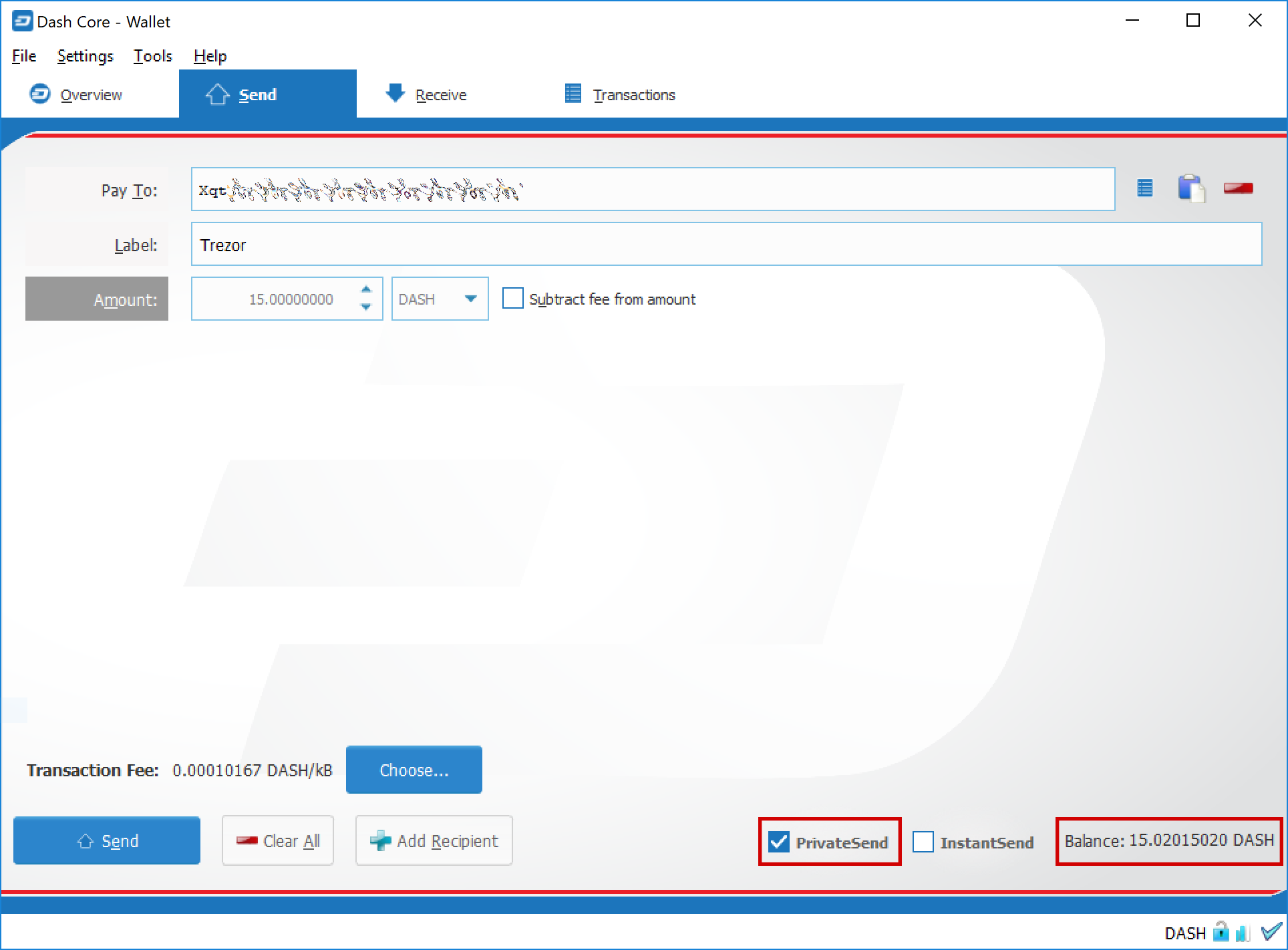

You can only use PrivateSend for payments once you have mixed enough Dash to make up the amount you are trying to send. Because the mixing process takes time, it must be done in advance before you create the send transaction. A PrivateSend transaction is effectively the same as any other transaction on the blockchain, but it draws only from input addresses where the denomination has previously been mixed to ensure privacy of funds. Because several input addresses are usually required to make up the amount you are trying to send, a PrivateSend transaction will usually take up more space (in kilobytes) on the blockchain, and therefore will be charged a slightly higher fee.
To send a payment using PrivateSend, go to the Send tab of the Dash Core wallet and enable the PrivateSend option. The balance displayed will change to show your PrivateSend balance instead of the total balance. You can then enter the Pay To address, Label, Amount and click Send as usual. Your payment will be rounded up to completely spend the lowest possible denomination of mixed balance available (currently to the nearest 0.001 DASH). You will be prompted to enter your password and receive a detailed breakdown of the fee structure for PrivateSend before sending.

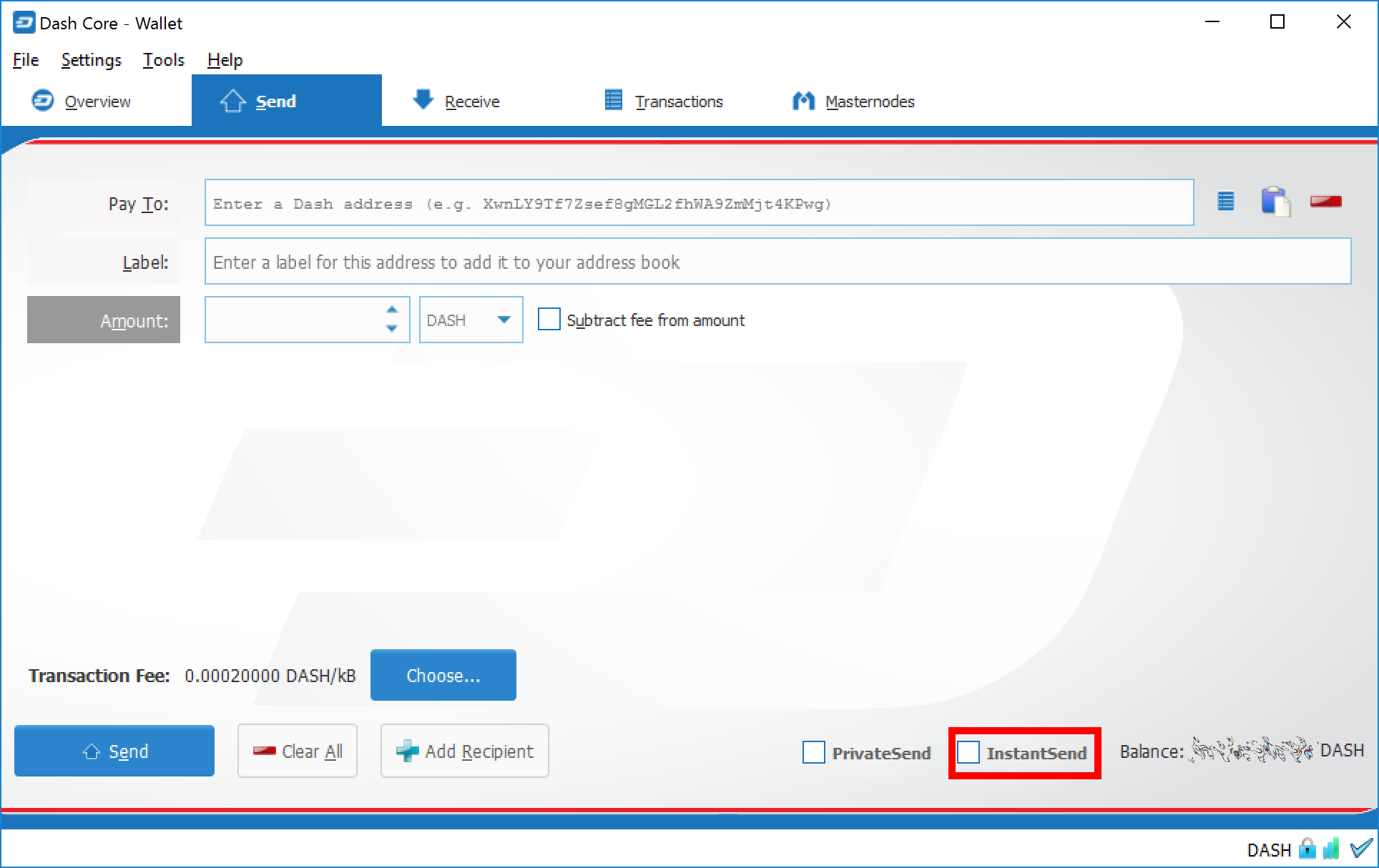

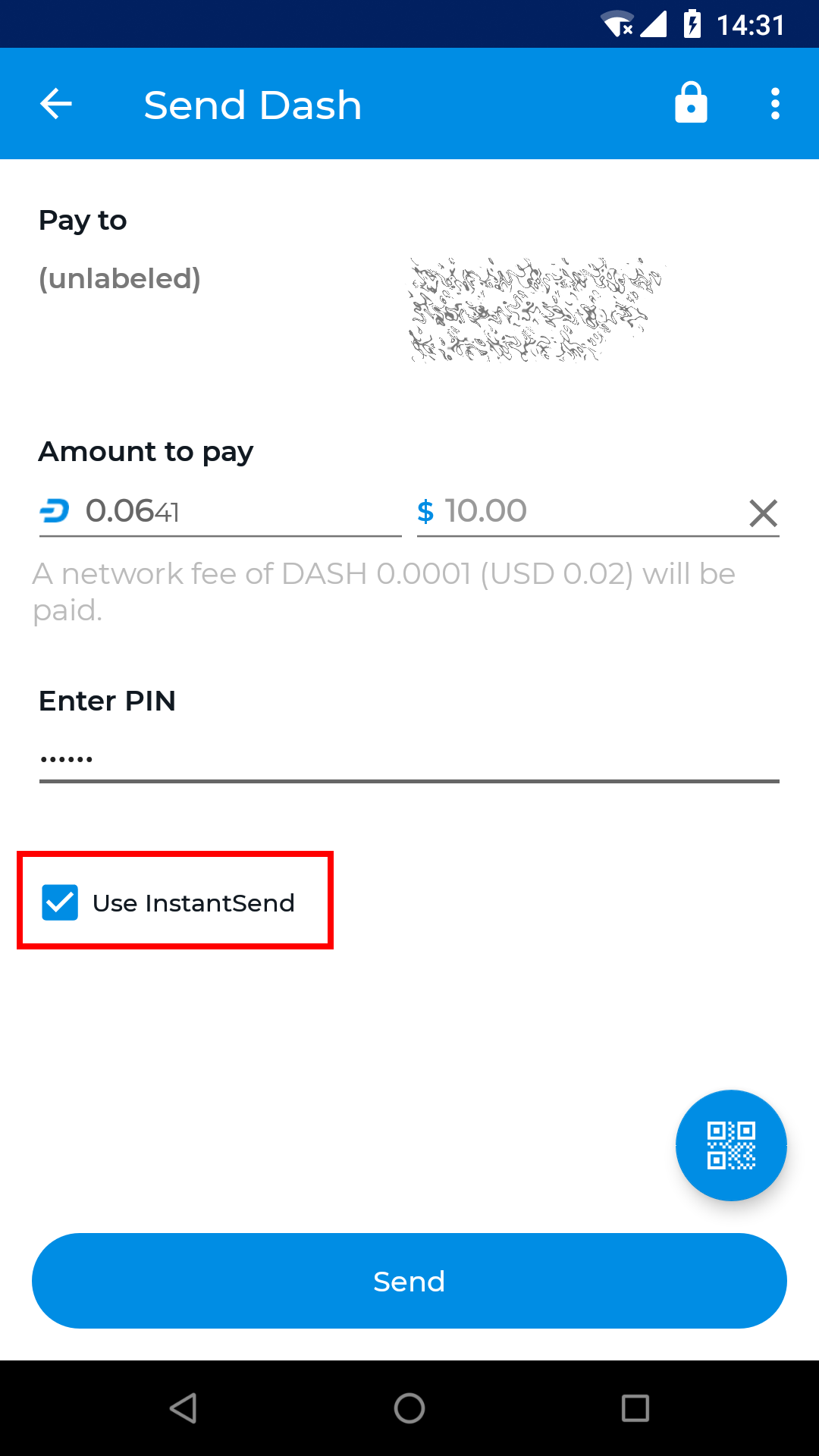

InstantSend functions by setting a flag on the transaction, causing deterministic selection of a quorum of 10 masternodes for each input spent in an InstantSend transaction. The masternodes examine the input, and if a majority determines it has at least six confirmations, they then accept the transaction. The input is then locked until the transaction has been confirmed in six mined blocks, at which point the output can be used as an input in another InstantSend transaction. This differs from inputs used in normal transactions, which can be spent after just one confirmation regardless of whether the Dash was received using InstantSend or not. A higher fee will be charged for InstantSend transactions with more than four inputs, according to the fee schedule. Note that the receiving wallet must also be aware of InstantSend in order to be able to immediately continue with the transaction or display an appropriate notification that the transaction should be considered locked. If the receiving wallet is not aware of InstantSend, it will simply appear as a normal transaction and you will need to wait for standard block confirmations.
如需使用即时发送功能,用户只要选中应用中的相关复选框就可以了。以下截屏显示了在Dash Core钱包、IOS和安卓钱包中找到相关设置的位置。
