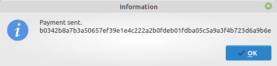

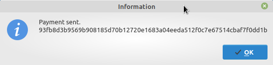

Transaction sent screen showing transaction hash¶
