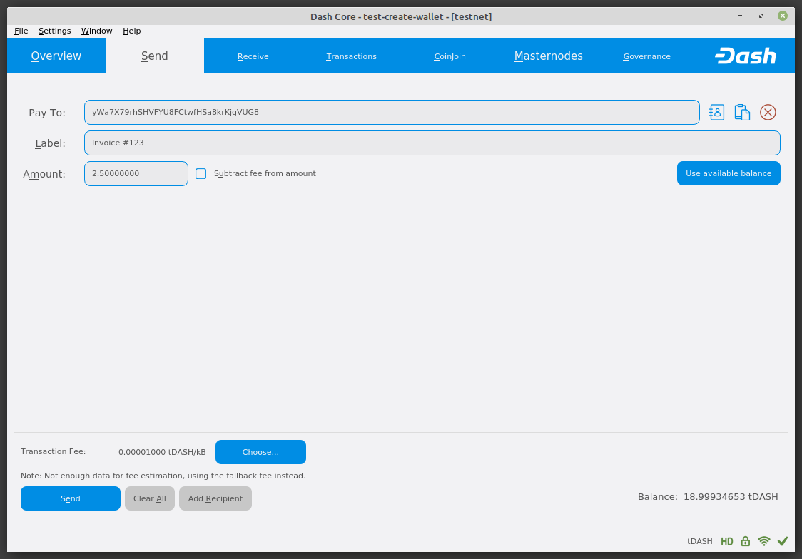

The other options relate to fees. You can choose if you want to pay the network fee in addition to the amount sent, or subtract it from the amount sent. You can also increase your fee to encourage nodes on the network to prioritize your transaction.
Let’s try an example. Say you have received an invoice which you now want to pay with Dash. The writer of the invoice has included a Dash address, which can be seen in the following window beginning with yWa. The invoice is for 2.5 Dash, which you fill in the Amount field.
Der für eine Transaktion ausgefüllte Tab „Überweisen“#

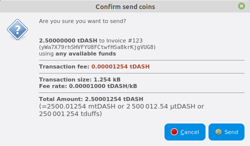

Vor dem Absenden muss die Transaktion noch einmal bestätigt werden, damit die Dash Core Wallet sie an die Blockchain weiterleitet. Ein Abbruch ist vor dem Absenden jederzeit möglich.
Abschließendes Bestätigungsfenster#

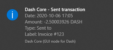

Durch das Drücken auf Ja wird die Transaktion abgeschickt. Das System wird nun eine Benachrichtigung herausgeben und die Transaktion wird im Transaktionen Tab dargestellt, wo auch ihr Fortschritt beobachtet werden kann.
Die Transaktionsbestätigung unter Windows 10#
Note that the amount of the transaction increased by .00003926 Dash. This is the transaction fee. In the next section, we will see what this procedure looks like from the receiving side.

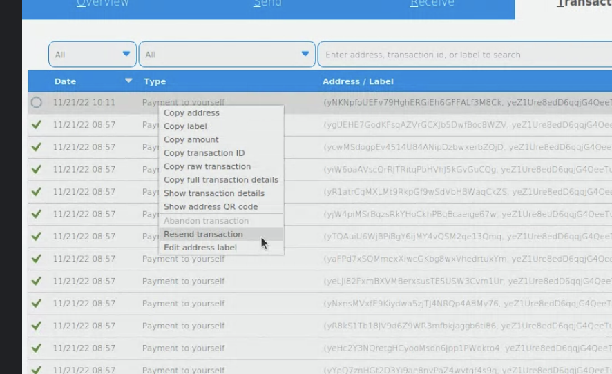

Stuck transactions can be resent one-by-one using the „Resend transactions“ option in the menu.
Resending transactions#

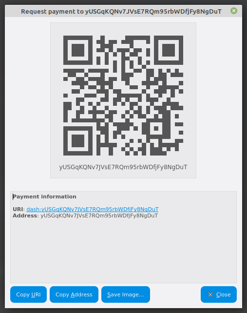

To receive Dash, you must first create a receiving address to give to the sending party. To do this, click the Receive tab in the tab bar.
Der Empfangen-Tab#
Create a new address by clicking the Request new receiving address button.
The Request payment window#
Click Copy Address on the Request payment window that opens and give this address to the person who will send you Dash. Your wallet does not need to be open to receive funds, but if it is, you can watch the transaction arrive in real time. This is because your wallet constantly watches for new blocks on the blockchain when it is open, and will recognize a new transaction involving your receiving address when it occurs.

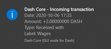

Die Empfangsbenachrichtigung unter Windows 10#

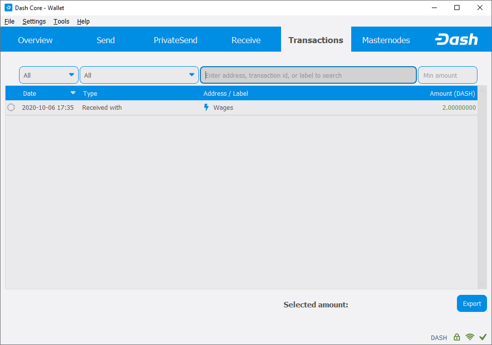

Nachdem die Zahlung durchgeführt wurde, kann der Betrag unter Übersicht und Transaktionen gesehen werden.
Die empfangene Transaktion#

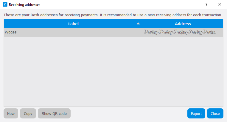

Viewing Addresses#
To view all previously created receiving addresses, click Window > Receiving addresses. In the same way, sending addresses can be seen by clicking Window > Sending addresses.
Das Empfangsadressenfenster#
You can edit an existing address by right clicking and selecting Edit address from the context menu.
