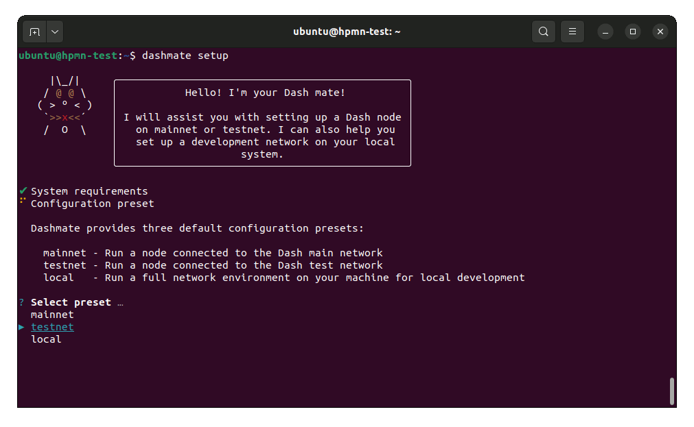

Masternode setup#
dashmate setup
Set Network and Node type#
Set up a new masternode#
