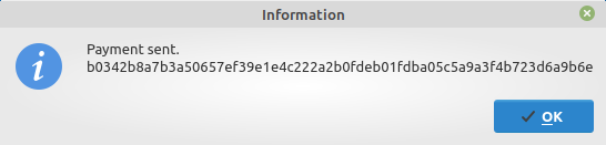

Registering your masternode#
Since the ProRegTx information required to register the masternode was filled out by the previous step, just Click Pay… to complete the registration.

Confirm ProRegTx Transaction#
Transaction sent screen showing transaction hash#
