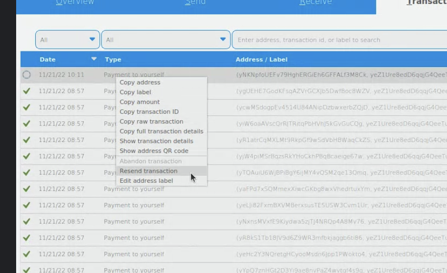

Stuck transactions can be resent one-by-one using the «Resend transactions» option in the menu.
Resending transactions#

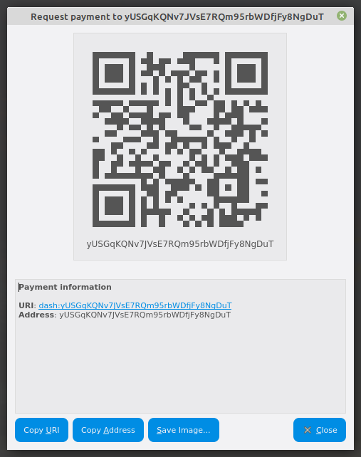

Create a new address by clicking the Request new receiving address button.
The Request payment window#
Click Copy Address on the Request payment window that opens and give this address to the person who will send you Dash. Your wallet does not need to be open to receive funds, but if it is, you can watch the transaction arrive in real time. This is because your wallet constantly watches for new blocks on the blockchain when it is open, and will recognize a new transaction involving your receiving address when it occurs.
