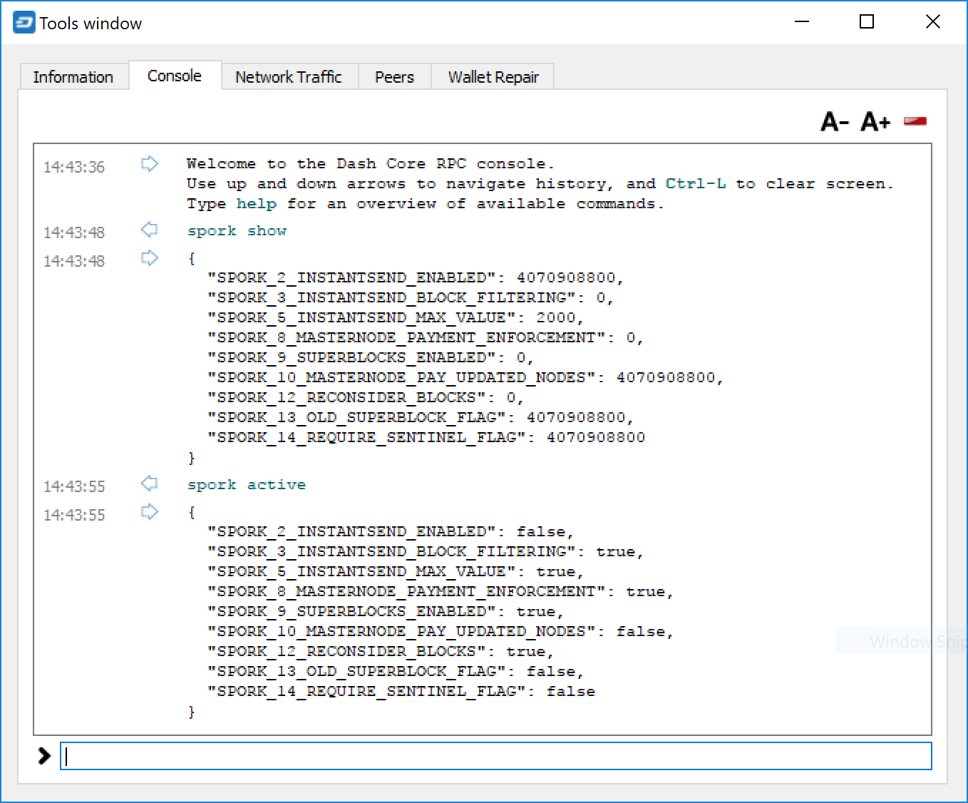

The spork show and spork active commands issued in the debug window (or from dash-cli on a masternode) allow you to interact with sporks. You can open the debug window by selecting Tools > Debug console.
../_images/dashcore-sporks.png
spork show and spork active output in the Dash Core debug console
