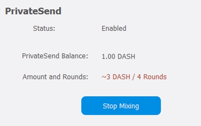

../../_images/mixing.png
PrivateSend interface after clicking the Start Mixing button. Note the Status is Enabled.
PrivateSend will begin creating transactions and your PrivateSend balance will gradually increase. This process can take some time, so be patient. You can monitor the process in more detail as described in the following section.

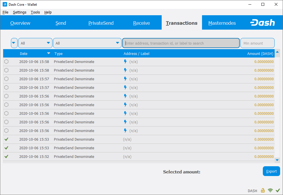

You can also monitor PrivateSend progress by viewing the transactions created by the process on the Transactions tab.
../../_images/privatesend-transactions.png
Transactions created by PrivateSend on the Transactions tab
The following table describes the PrivateSend-related transactions displayed in the Type column of the Transactions tab:

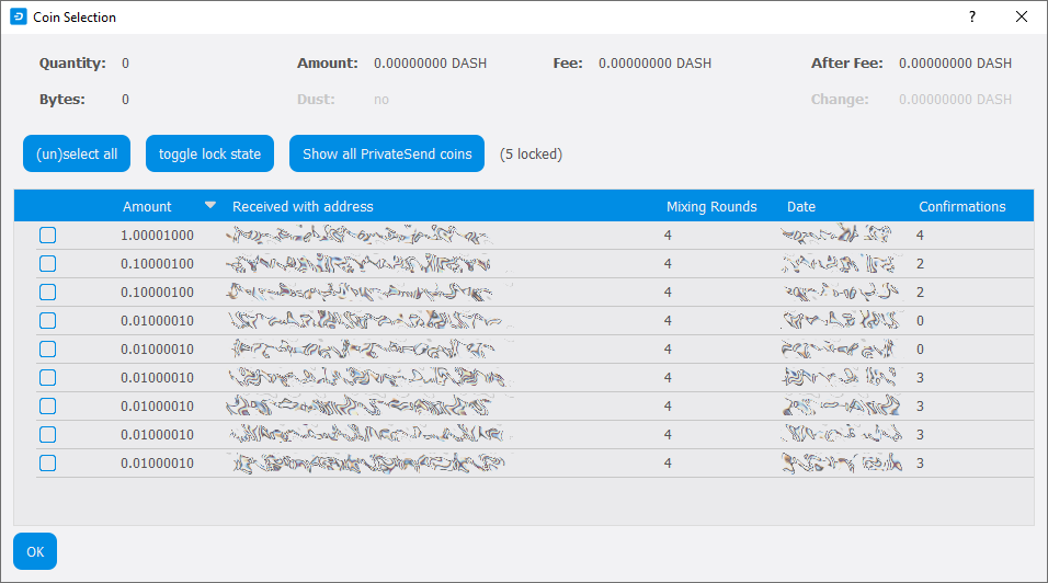

You can also use the coin control feature to view which addresses hold denominations ready to be used for PrivateSend transactions. Go to the Send tab of your wallet and click Inputs to view the possible input addresses for your transactions. You can see how each address holds given denominations of Dash, and how many rounds have been completed. This is to ensure that an efficient combination of addresses can be used as inputs in PrivateSend transactions without too much change, since an amount in a PrivateSend transaction must be rounded up to completely spend all inputs. The current minimum balance for an input used in a PrivateSend transaction is 0.00100010 DASH.
../../_images/privatesend-addresses.png
Coin Selection dialog showing addresses holding PrivateSend balances in different denominations

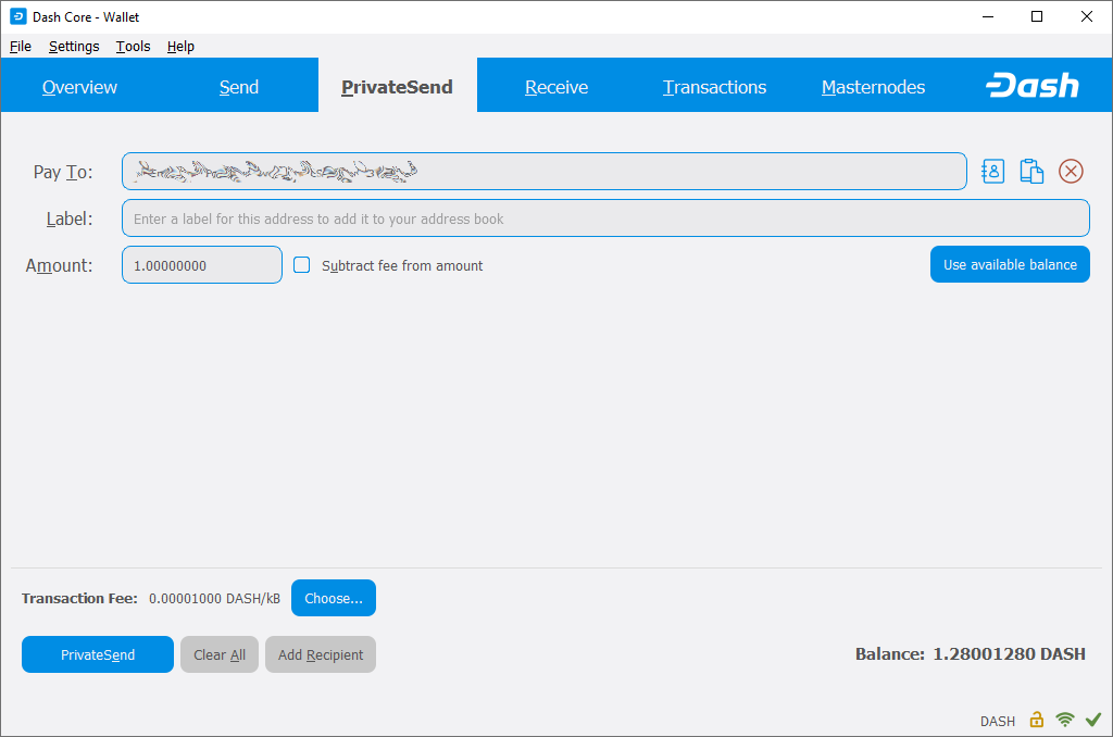

To send a payment using PrivateSend, go to the PrivateSend tab of the Dash Core wallet. The balance displayed is your PrivateSend balance instead of the total balance as shown on the Send tab. You can then enter the Pay To address, Label, Amount and click PrivateSend. Your payment will be rounded up to completely spend the lowest possible denomination of denominated balance available (currently to the nearest 0.001 DASH). You will be prompted to enter your password and receive a detailed breakdown of the fee structure for PrivateSend before sending.
../../_images/privatesend-send.png
Dash Core ready to send a PrivateSend transaction. Note use of the PrivateSend tab and the amount to be sent is less than the available PrivateSend balance
