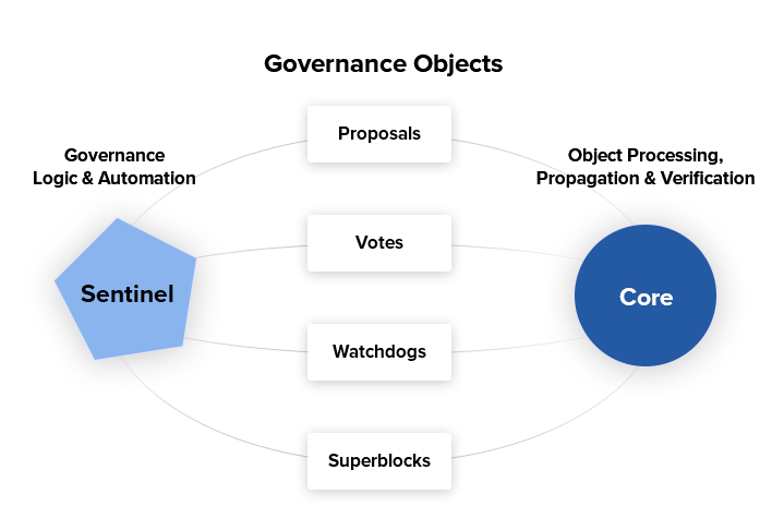

Sentinel
A Governance Object (or "govObject") is a generic structure introduced in Dash 0.12.1 to allow for the creation of Budget Proposals and Triggers. Class inheritance has been utilized to extend this generic object into a "Proposal" object to supplant the current Dash budget system.
../_images/sentinel.png
Diagram highlighting the relationship between Dash Sentinel and Core
