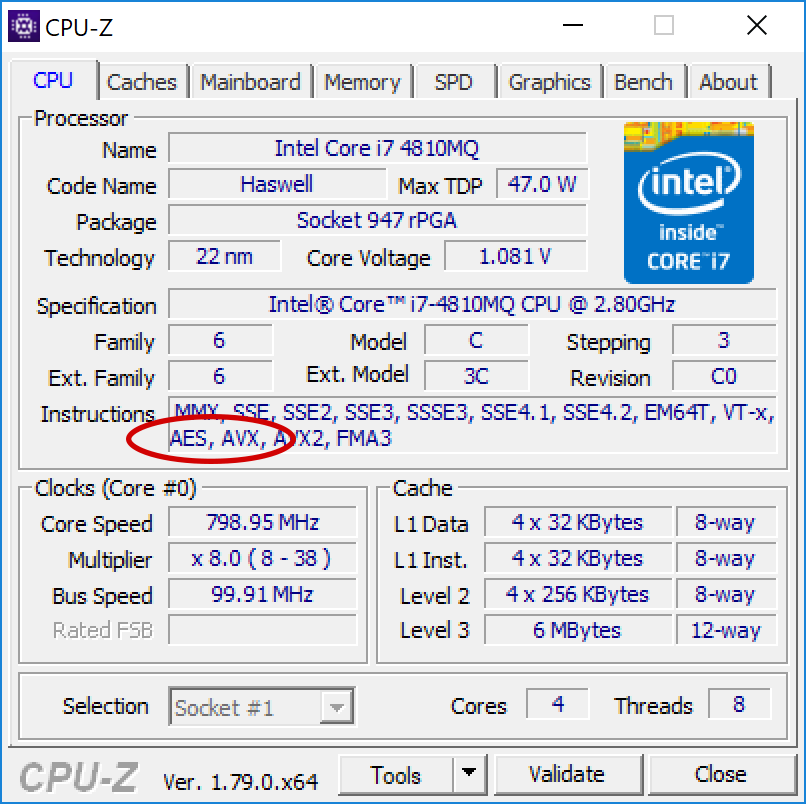

Mining software
The first step is to download appropriate mining software. A good basic miner for modern CPUs can be found here:
../_images/cpu-z.png
CPU-Z showing details for an Intel i7 Haswell CPU
If your CPU does not support AES-NI and AVX, then you can try more generalized software which does not require specific instruction sets, such as these:
Our goal here is to choose mining software that supports the maximum possible instruction sets available on your CPU, and then try to increase the hash speed. Once you have made your choice, click Releases and download and extract the zip file. The different *.exe files indicate which specific processor optimizations they support. The folder should look something like this:

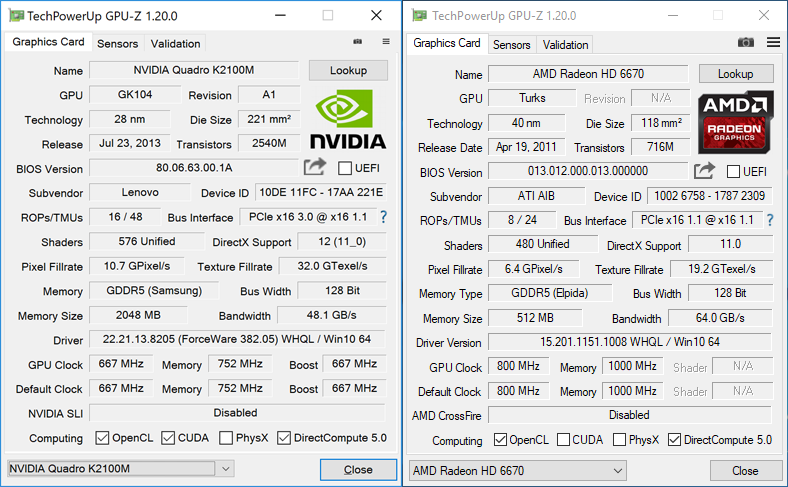

Mining software
As for CPU mining, a range of mining software is available for GPU mining. Most of it based on sgminer compiled with different optimizations specific to different hardware. A good approach is to identify your graphics hardware, then choose an appropriate build of sgminer. You can use GPU-Z to identify your GPU hardware:
../_images/gpu-z.png
GPU-Z showing details for AMD Radeon Turks and NVIDIA Quadro GK104 class GPUs
Next, download the mining software. Most of these are based on the original sgminer, but this is not suitable for the X11 algorithm, offers no compiled binaries and hasn't been updated in years. We will describe using pre-compiled binary software maintained by newer developers only.
