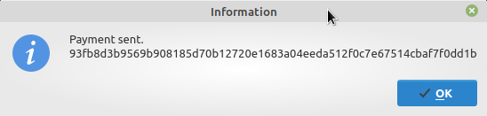

../../_images/mn-proregtx-sent-confirmation.png
Transaction sent screen showing transaction hash

../../_images/mn-proupservtx-sent-confirmation.png
