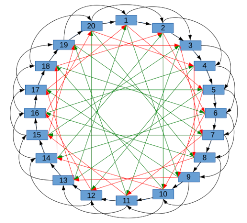

Intra-Quorum Communication#
The DKG and the signing sessions performed after LLMQ activation require many messages (up to one per phase and per member) to be propagated. Most of these messages are not of interest for nodes outside the LLMQ. Using full propagation (to all nodes) of all these messages would slow down the DKG and signing sessions dramatically. It would also impact the performance and stability of the whole network.
As a solution, we introduce the concept of “Intra-Quorum Communication”. Each LLMQ member is required to connect to a deterministically selected set of members and keep these connections open for the whole DKG and quorum lifetime. The way the required connections are determined ensures that there is always a path with low numbers of hops from each member to each other member. It also ensures that failure of individual members in the LLMQ does not result in total failure of the DKG and LLMQ.
When messages need to be propagated to all other members, the members will then only push inventory items and messages to this deterministic set of connections. The other members will perform the same, until the message is propagated to the whole LLMQ.
Building the set of deterministic connections#
Every member of the quorum has to build its own list of deterministic quorum connections. This is done the following way:
  1. Build the deterministic list of quorum members (See Initialization Phase of the DKG protocol).
  2. Loop through the list until the member finds itself in the list. The index at which it finds itself is called i.
  3. Calculate indexes (i+2^k)%n where k is in the range 0..floor(log2(n-1))-1 and n is equal to the size of the list.
  4. Add addresses of masternodes at indexes calculated at previous step to the set of deterministic connections.
The result can be imagined as a circle of nodes.
Building intra-quorum connections
Most messaging between members is performed using the inventory system of Dash. This means that members will first send INV messages to other members and respond to GETDATA messages. Some communication messages, however, will be directly sent (see DIP007 - LLMQ Signing Requests/Sessions) to quorum members without using the inventory system.
