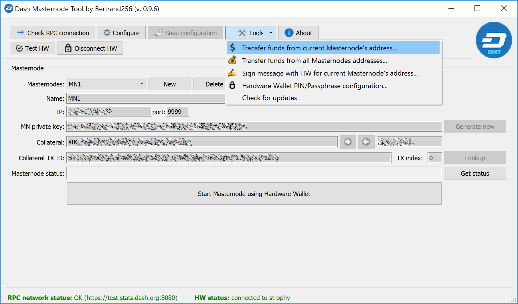

Open DMT and verify the RPC and HW connections are working. From the Tools menu, select Transfer funds from current masternode’s address or Transfer funds from all masternode’s addresses, if you use DMT to control multiple masternodes.

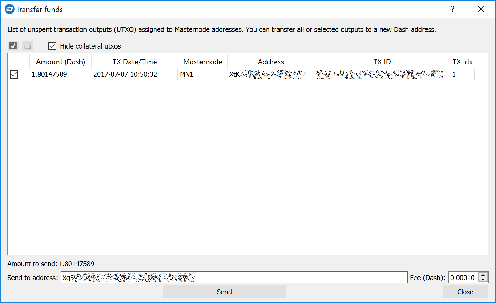

DMT will load for a moment, then display a window showing the available UTXOs you can use in your withdrawal. By default, all UTXOs not used as masternode collateral are checked. The masternode collateral UTXOs are not only unchecked but also hidden in order to avoid unintentionally sending funds associated with collateral and stopping your masternode. You can show these hidden entries by unchecking the Hide collateral utxos option. Enter your destination address for the transaction. The window should appear as follows:

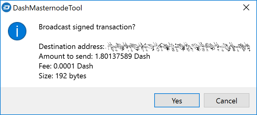

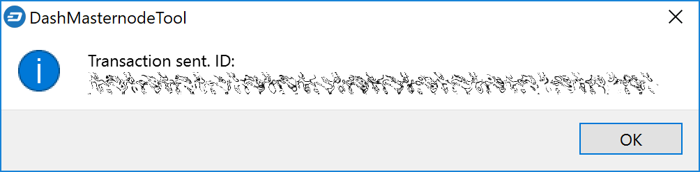

Verify the transaction fee and click Send. Your Trezor will prompt to enter your PIN and confirm the transaction on the device. Once this is done, confirm one more time to DMT that you want to broadcast the transaction to the network by clicking Yes. A confirmation with the transaction ID will appear.

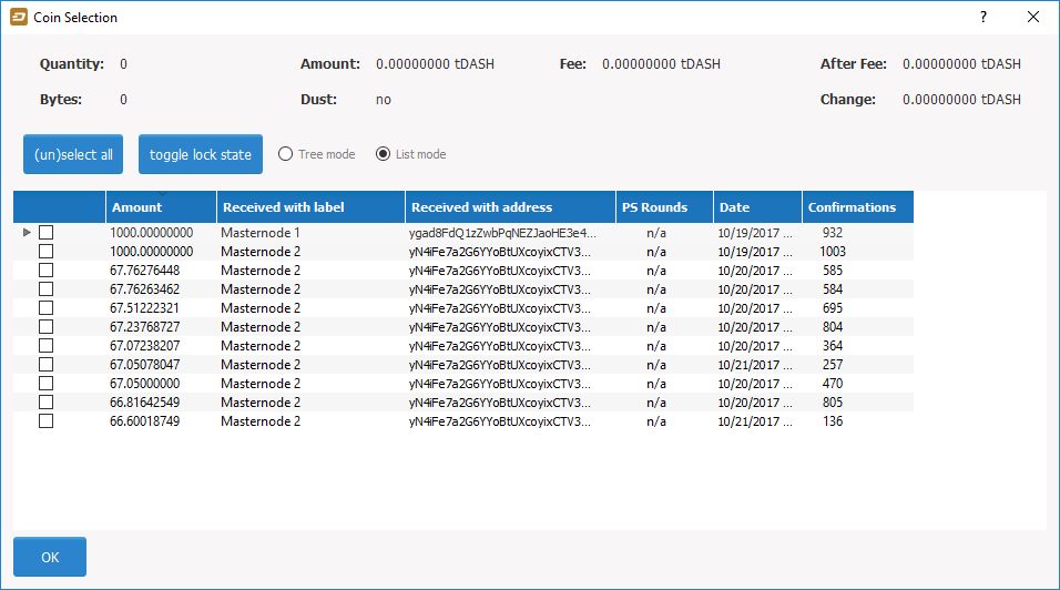

Similar to DMT as described above, we need a method in Dash Core wallet to restrict which UTXOs are spent when making withdrawals from a masternode address to ensure that the collateral UTXO is not touched. In Dash Core wallet, this feature is known as Coin Control, and it must be enabled before you can use it. Click Settings > Options > Wallet > Enable coin control features. Now, when you go to the Send tab in your wallet, a new button labelled Inputs… will appear. Click this button to select which UTXOs can be used as input for any transactions you create. The following window appears:

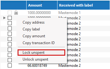

Right click on the transaction(s) showing an amount of 1000 DASH, then select Lock unspent. A small lock will appear next to the transaction. Then click OK. You can now safely create transactions with your remaining funds without affecting the original collateral UTXOs.
