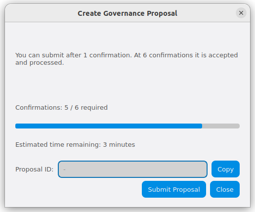

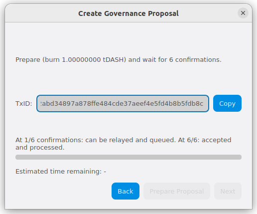

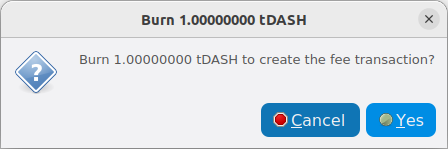

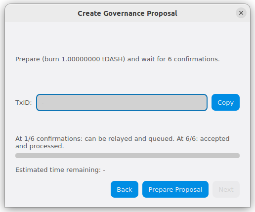

Next, the proposal generator will provide you with a command to run from the console of your Dash Core wallet to prepare your budget proposal governance object. Running this command will cost you 1 DASH, which will be «burnt» or permanently removed from circulation. This one-time fee protects the governance system from becoming overwhelmed by spam, poorly thought out proposals or users not acting in good faith. A small transaction fee is charged as well, so make sure slightly more than 5 DASH is available in your wallet. Many budget proposals request reimbursement of the 1 DASH fee.

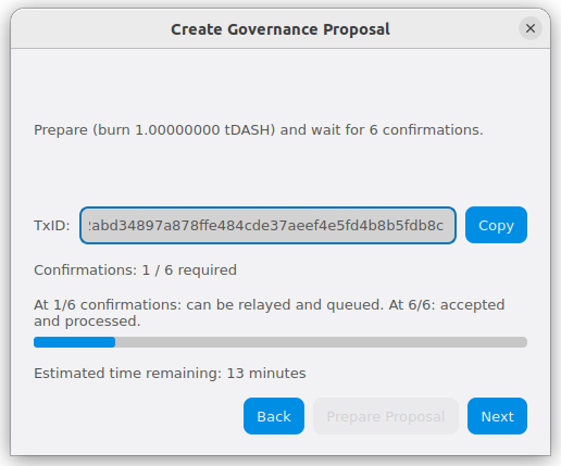

Paso 3: crear la transacción de propuesta y esperar 6 confirmaciones de la identificación de transacción#

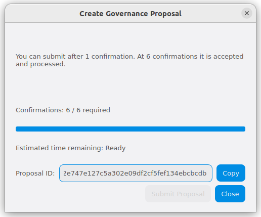

Una vez que existen 6 confirmaciones de bloque, aparecerá otro comando para enviar el objeto preparado de gobvernanza a la red para votar. Copia y pega este comando, y tu identificación de objeto de governanza aparecerá de la siguiente manera:

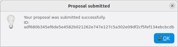

Paso 4: enviar el objeto de governanza a la red#
Puedes usar esta identificación para seguir la votación de la propuesta hasta que cierre el presupuesto y recibas tu pago. También puedes enviar la identificación a DashCentral para reclamar tu propuesta y permitir una votación simplificada para los masternodes utilizando los servicios de votación de DashCentral.

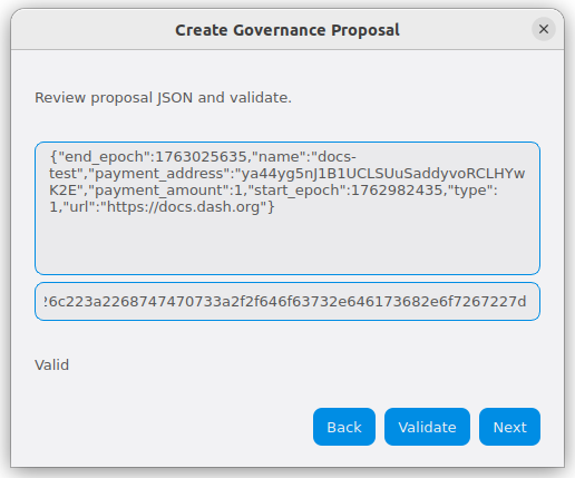

Assemble the proposal data#
"name": "Test-proposal_1",
"payment_amount": 10,
"start_epoch": 1635750000,
"end_epoch": 1636750000,
"type": 1
Set the type
field to 1
for all proposals.
The start_epoch
and end_epoch
fields are Unix epoch timestamps
indicating the time range in which the proposal can receive payments. Typically
you will set the start_epoch
to approximately halfway between the superblock
where payment is first desired and the preceding one. Set end_epoch
to
approximately 2 weeks after the superblock where the final payment is desired.
You can use a site like https://www.epochconverter.com/ to convert the start and
end dates to the epoch values for these fields.
Serialize the proposal data#
Finally, open your Dash Core wallet console and use the gobject prepare
command to complete the proposal preparation and submit the collateral
transaction. See the Core developer documentation for additional details.

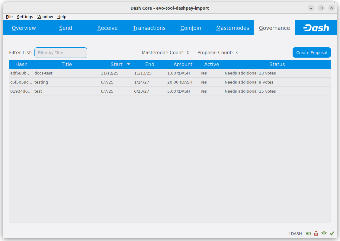

Votar por las propuestas#
Debes votar al menos tres días antes de que se cree el superbloque o tu voto no se contará. La fecha límite exacta es 1662 bloques antes del superbloque.
Para obtener información sobre cómo crear una propuesta, consulta aquí.
DashCentral#
Muchos operadores de masternodes almacenan sus llaves privadas protegidas por contraseña en DashCentral para permitir una votación simple con una interfaz fácil de usar. La popularidad de este sitio lo ha convertido en un lugar común para el debate de las propuestas una vez que se han enviado al sistema de governanza. Para votar desde la interfaz web de DashCentral, primero agrega tu llave privada del masternode a tu cuenta de acuerdo con las instrucciones aquí descritas. Ten en cuenta que la llave privada del masternode no es lo mismo que la llave privada que controla la garantía de 1000 DASH, por lo que no hay riesgo de perder tu garantía. Se requiere una contraseña diferente para desbloquear la llave privada del masternode para votar, por lo que el riesgo de que el operador del sitio vote a tu nombre es mínimo.
Cuando estés listo para votar, vaya a la página propuestas de presupuesto. Haz click para ver las propestas, luego haz click para Votar SI, Votar Abstenerse o Votar NO.
Interfaz de votación en DasCentral#
Herramienta de Dash Masternode (DMT)#
Si iniciaste tu masternode desde una billetera de hardware usando DMT, también puedes usar la herramienta para emitir votos. Haz click en Herramientas > Propuestas y espera a que se cargue la lista de propuestas. Puedes ver fácilmente el estado de votación de cada propuesta y seleccionar una propuesta para mostrar los detalles en la pestaña Detalles en la mitad inferior de la ventana. Pasa a la pestaña Votar para Votar SI, Votar No o Votar Abstenerse directamente de DMT.
Interfaz de votación en DMT#
