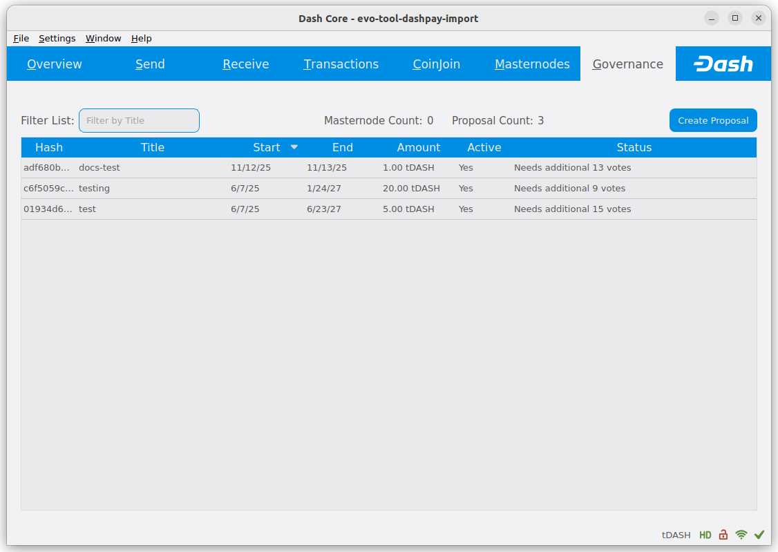

Accessing the Governance tab#
Open your Dash Core Wallet and click on the Governance tab. This displays a list of existing proposals and provides a Create Proposal button in the upper right corner.
../../../_images/governance-tab.png
The Governance tab showing existing proposals and the Create Proposal button#

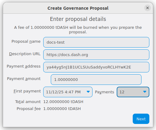

Creating a new proposal#
Click the Create Proposal button to open the proposal creation dialog. Enter your proposal details:
  • Proposal name: A unique identifier
  • URL: Link to detailed proposal information (use a URL shortener if needed)
  • Payment address: The Dash address that will receive payments
  • Payment amount: Amount requested per payment cycle
  • First payment date: Select the superblock date for the first payment
  • # of payments: Number of payment cycles requested
The dialog displays the total amount requested and notes the 1 DASH proposal fee that will be burned. Click Next when all fields are complete.
Entering proposal details in the creation dialog#

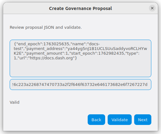

Validating the proposal#
The wallet will generate and display your proposal data in JSON format along with the proposal hash. Review the information carefully to ensure accuracy.
Click Validate to check the format of the proposal data. If the data is valid, click Next to proceed to the next step. Otherwise, click Back to adjust your proposal data.
../../../_images/proposal-validate.png
Validating the proposal JSON and hash#

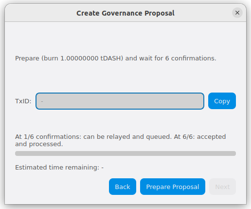

Preparing the proposal fee#
Avvertimento

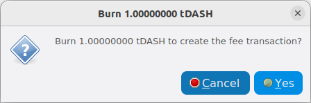

The following step will create a transaction burning 1 DASH as the proposal submission fee. This transaction is irreversible once broadcast. Verify all proposal details are correct before proceeding.
After validation, you will see a screen prompting you to prepare and burn the 1 DASH proposal fee. This fee is required to prevent spam and is permanently removed from circulation. Click Prepare proposal to create the fee transaction.
../../../_images/proposal-prepare-burn.png
Proposal fee burn preparation screen#
Click Yes on the confirmation dialog to broadcast the fee transaction.
../../../_images/proposal-burn-fee-notice.png
Confirmation dialog for burning the proposal fee#

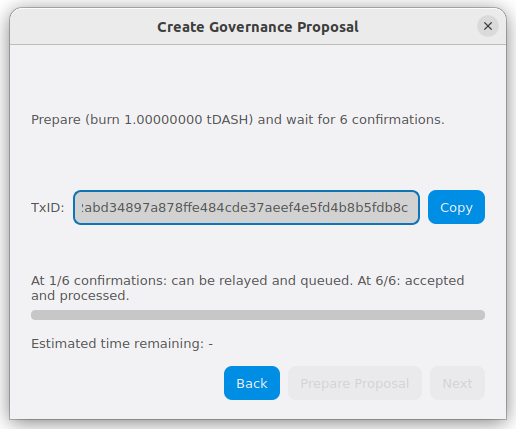

The transaction ID will be generated and displayed in the TxID field.
../../../_images/proposal-prepare-burned.png
Transaction ID generated for the proposal fee#

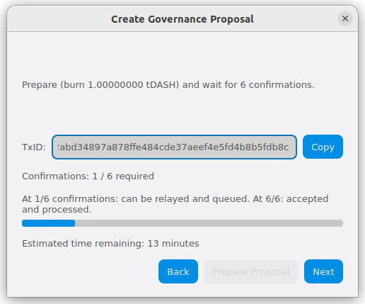

Waiting for confirmations#
The wallet will display the confirmation progress for your fee transaction. One confirmation is required before you can submit the proposal to the network. After the first confirmation, click the Next button to move to the proposal submission screen.
../../../_images/proposal-prepare-burned-conf-wait.png
Waiting for confirmations (1 of 6)#

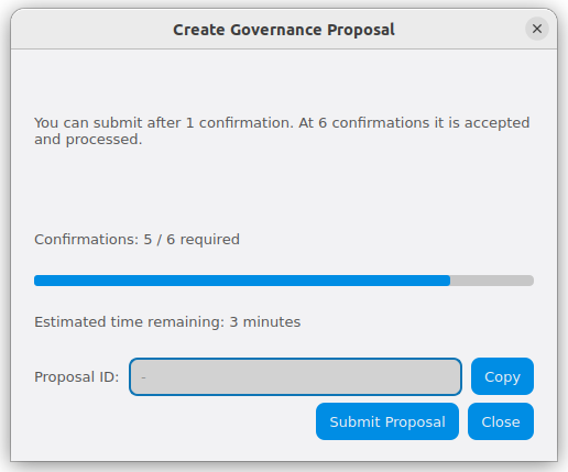

Submitting the proposal#

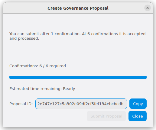

Click Submit Proposal to broadcast your governance object to the network.
../../../_images/proposal-submit-awaiting.png
Submitting proposal with 5 of 6 confirmations#

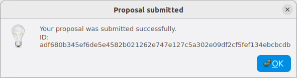

If successful, a message will be displayed with your proposal ID. Click OK to close the message.
../../../_images/proposal-submitted-conf.png
Proposal successfully submitted to the network#
